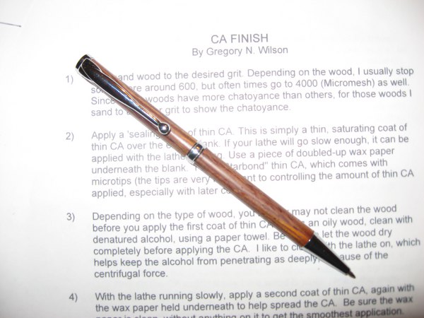

I know you all talked about patients and practice but I couldnt stand it. I was going to turn somthing TODAY, NOW. My chisel set didnt get here til noon. I already had the wood mounted in the lathe and waiting I thought if the chisel set didnt come today I was just going to sharpen a screw driver and use that.
The only practice I had, I turned a piece of oak into a spindle so I could mount it into my drill press and use that to press my pens together. It worked good.
I had no problem turning. The cocobolo wood turned pretty easy. When I got down to where I was about 1/8 I used the skew and then stopped at 1/32 bigger than the bushings.
Sanding wasnt a problem, it was the easiest part. But when I added the CA with the wax paper it all went to hell. I should have just polished it up with some wax and left the CA alone.
I added 1 thin coat then sanded with 1200 or 1500 micro mesh just to dull it up and added another coat and waited for it to cure. When I started tring to finish it everything look good until I put on the wax and waited for that mirro shine. It came out a little cloudy with some shiny groves down in the grain. So I tried to sand it all off and try again and again and again so now I have a pic of my first dull over turned slimline.

congrats....A lot better than my first. The finish will get easier as you go. I like the fact that you made a true slimline. Most folks are afraid to take off the wood and make a fat slimline. I did.:redface:

Oh yeah, that's a nice first pen... keep it as a memento... I still have the first pen I made.

Definitely a good first effort!

As for the CA finish, you will find about 897 ways to do it here, (and that's just on the first page of a search). It all boils down to "Get it on, get it smooth, get it polished". All the rest is just details. I'm just now getting one that seems to work well for me.

Nice 1st Pen
Your first looks better than my 1st. I still have mine in the pen case just to see how I have imporved over time. I recently finished my 150th pen. Enjoy the hobby, this is a gret site to learn the craft.

I'm impressed. Especially using a skew right off. I suspect that if we didn't always complain about how diffult a skew is to learn a lot more of us would have mastered the skew by now.

Nice first pen - a better job than my first one which has never been photographed...and never will be!

Nothing wrong with a slightly overturned pen. I have a couple that I and others actually like writing with.
Looks pretty good to me.
my first is hidden in my sock drawer, i agree with whoever mentioned the fat first slimline, mine resembles a short cigar pen :redface:
