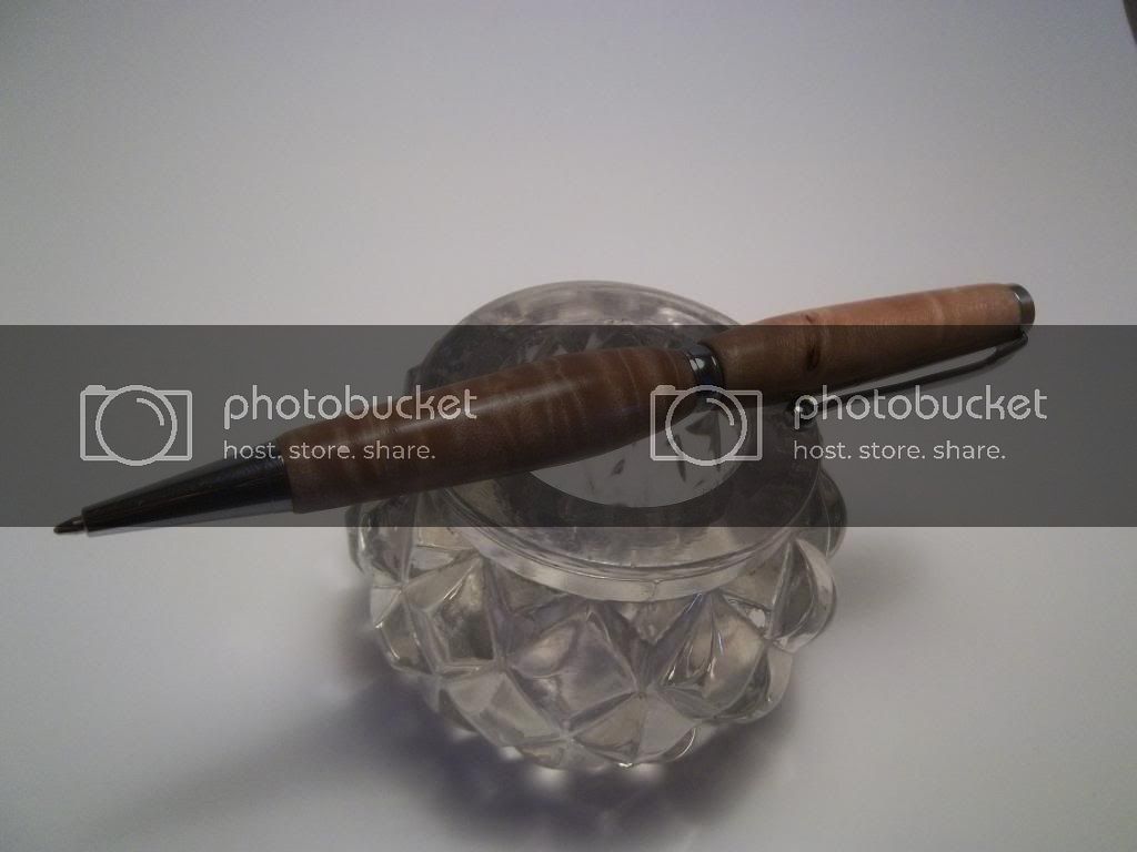

To answer to old saying, yes, this is my first day on the job. New member here today, turned my first pen 2 days ago. It came out bad. The first lesson I learned was ORDER THE BUSHINGS THAT MATCH THE KIT. Got a cheap starter kit, thought bushings were in it. So my first turn was a crap shoot and my wood to metal fit is horrible. My OCD wont tolerate that. Plus, my son suggested the shape of the lower section, which is very comfortable, but ugly. Reminds me of in the past women putting on tight corsets to reduce waist size, but still had a big butt. But thats just me. The maple came from a tree I cut down and was splitting for firewood and it just spoke to me and said save me. That was 20 years ago.
This pic represents rock bottom for me, a place to start.

Hey that isn't a bad start at all. That wood spoke to you right and it is a beautiful piece with great curl to it. Welcome to the beginning of a great journey. Pen turning is one of the most rewarding things I have done. It never gets old because you can always try something new. Read through the library and other more specialized forums and find out what others are doing. Don't be afraid to ask questions.
That "belly" is common for new pen turners to want to create that new beautiful shape or fear taking too much off at first. Wish my first pen turned out that well, I couldn't even get mine to take a shine or twist open for that matter. Had to learn to disassemble it to get it to work before I even tried it out. I didn't save my first...wish I had.
Way better than my first one. I gave my first one to my wife (who loves it BTW, but then again she is married to me), so I can always look back to see how I've progressed. I'm up to pen 25 now, and while I am no means a master, I am turning pens that I can be proud of. I actually sold my first one last week. This site is a treasure chest of information. I never try a new technique without checking here first. Welcome!

That's not bad at all compared to my first one. I kept turning and turning until it couldn't get any thinner and I spent 4 hours just trying to apply a CA finish which is why I call my first pen caca :redface:
That pen is a keepsake and a reminder of a new beginning. Keep it and in time you should be amazed at how far you've come.
Doug; That pen is not that bad for a first turn. The secret to proper fit, is to use the bushings only as holders for your blanks. Get the wood down close to them, but use a calipers to measure both your fitting and your blanks for final fit. Also if you don't use the center band, you aren't limited in the shape or size of your pen. Use the library to gain knowledge. Jim S
I ditto what everyone else said about keeping and looking back at it if you plan on doing this for awhile. One other thing since this is your first photo shown, please down size your photos. They are too big. No need for that. Welcome aboard.

Showing pens on the forum allowed me to enjoy your pen I see you rounded the timber at the pointed end and the band then left the timber proud at the start of the top. You then recovered next to the clip. So as you said bushings would have guided you. Now also the pen kit can be changed by using a fatter band that allows more timber to be saved, other shapes to create. Having some means of measuring to allow matching sizes to the tip, band, clip conquers this.
Your finish is good the picture gives a clear view of the pen this often takes years for some members, I regard it as a worthy first one keep it at your own peril you could turn into a hoarder like me. My first car was an A Model Ford Tourer would I like to have it now, no way loved it in every way however moved on needs change.

You must be new to this, you say this is your first and worst pen. Trust me as you go along and try new things you will make worse ones. :eek: Save this one forever, you know where you can improve and just have fun with it.
Hey Doug, give yourself a break!!
Fit and finish comes with time. The turn looks good,slims are the pen that will make you a better turner because they are unforgiving of errors.
