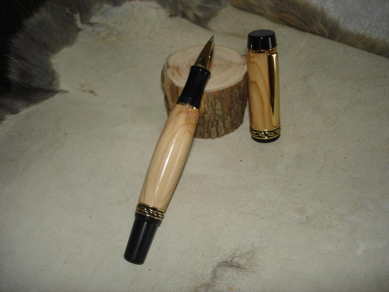

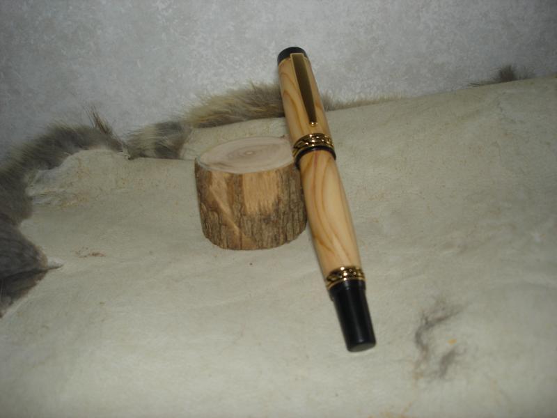

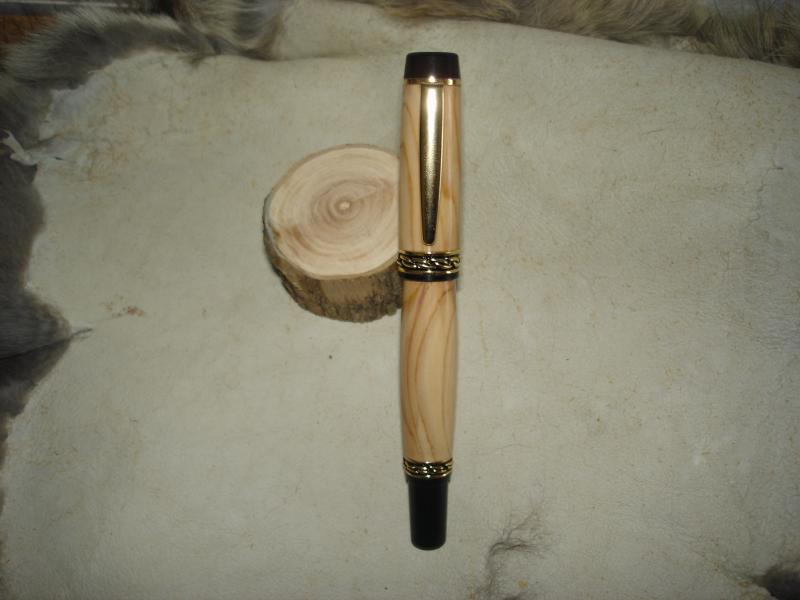

The is the pen that nearly took my left index finger two weeks ago. The bark or the small twig coming off the blank snagged the table saw blade and it twisted out of my hand. Fortunately I have the reflexes of a slow arthritic cat, and only got the tip of my finger chewed up some. The wood is lilac on an Olympian II. Six coats of medium CA mm'd to 12000

Nice looking pen, and I know all about table saws, I lost 1/2 of an index finger and most use of the middle finger, making a pen for my Doctor.
Is the prop in your picture the rest of your original blank? Were you cutting a round blank on the table saw?
I cut two of my fingers years ago on a table saw, and I never use one the table saw now without using a push stick or push block, especially when cutting something as small as a pen blank.
The pen looks very nice.
yes I was. the pen is actually resting on the twig that most likely caught the blade. I'll be cutting/breaking off any twigs I find on wood from now on, as well as scraping off any loose bark.
