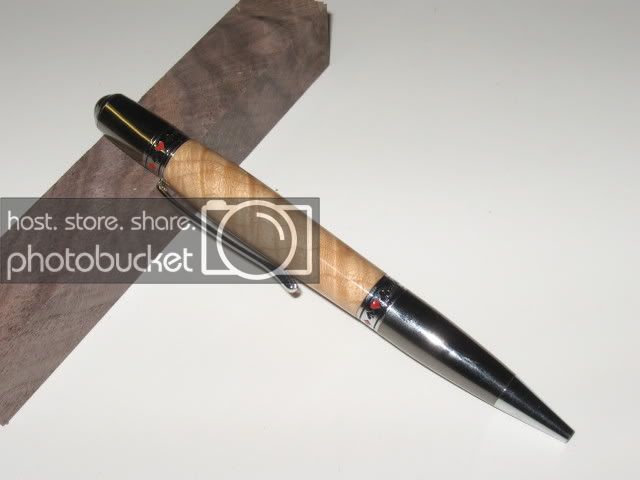

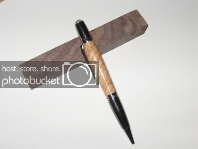

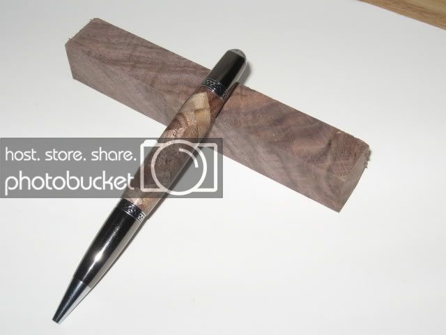

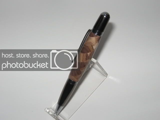

Hello, first a big thanks to marcruby for the good conversation over a couple bites to eat,and a giant thank you for the great advice on doing CA finish.I was unable to do CA until he healped me with some good direction,this is what I love about the IAP.These are two gifts one a segmented walnut and then just a nice piece of curly maple.I'm not happy with the way the blanks stands proud of the hardware by a tiny amount(you can see it in the walnut pen most of all)this is due to my between center bushings being the a little bigger then the kit hardware.Please share your thought good or bad,you can't hurt my feelings.Thanks everyone for everything.Victor

Those kits look like Tapa Pacifica from Woodpenpro. One looks like a regular one, and the other looks like a Poker Pen. He has several different varieties of them. They both look good to me, and doesn't it just feel GREAT when you get that finish down?
Nice work Victor, I also favor the walnut segmented pen the best, I just made some between center bushings just for sanding and CA, I made them from Delrin and while the tub fits so snug it's hard to get them to keep from pushing out from trapped air, but the shoulder part of the bushings are .010 undersize of the kit hardware, but I use calipers, did a set for Elegant beauty's and a set for Jr. Emperors, makes sanding and CA application easy.
Great job Victor!! Try using the bushings just for getting CLOSE. When you get close, remove the bushings and put the blank between centers for the sanding. Use your calipers from then on. MERRY CHRISTMAS!
