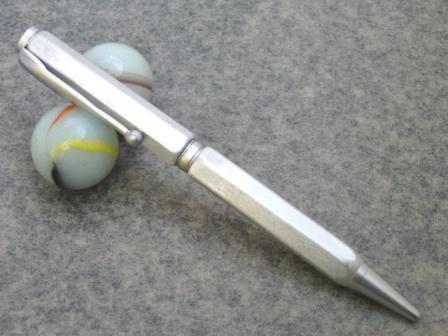

I found a piece of alum. in the workshop so decided to try and make a pen. This is the results. I`m not too pleased with the finish too many scratch marks. Gonna have to come up with a better way to finish. What do you think?
Perry, Hex stock will probably have a a lot of draw or roll lines, My suggestion would be start with 220 wet or dry,lubricate with cheap oil, put it on a piece of glass or real flat wood, (glass or thick acrylic sheet,will work better rub one side at a time back and forth until the surface looks even then go to 400 grit same thing, lube with oil or even WD-40 cheap oil works better, then go to 600 same story then polish with Flitz, Brasso, even chrome polish, it should nearly blind you. or buff with tripoli and white diamond,
Nice job though..
I like the shape.. it has lots of potential.
