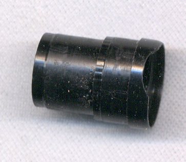

Recently bought a couple of Ligero Platinum FP kits from AZ on closeout... have to admit it is a nice kit.. basically the same size as the El Grande, but feels a bit better. The FP nib writes very well.. I am impressed with it... the only problem I found is that if you are not careful when pressing the center cap onto the upper barrel the edge will fold and bend... really ticked me off.. it is soft material.. it should have been made from harder plastic.. So I own another FP..

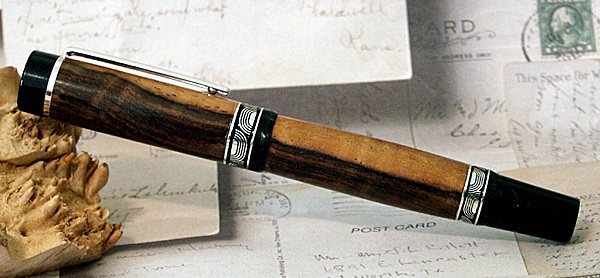

Here it is
Black Chacate ... new wood from the CSU catalog only $0.95 for a 1x1x10" piece.. I ordered 6.. 3 have the tan sapwood and the others are all heartwood.. heartwood is dark brown with light brown grain.. on the ones with sapwood/heartwood, there is a very dark brown line between them.... very pretty.. also a hard wood.. came off the skew more in chips than ribbons.. sands very well and takes a finish well.. finish on this was sanding sealer and TSW to a semi gloss polish
