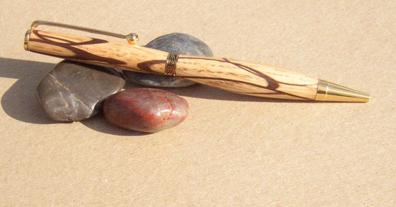

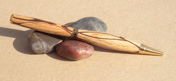

This is my first attempt at a laminated blank. It is oak with walnut veneer, sealed and finished with CA-BLO. Still having a little trouble with out-of-round blanks due to the #$#%% mandrel.
I made the blank by cutting "random" wavy sections on a scroll saw, which gives the unpredictable pattern.

Nice pen!
I sometimes have a problem getting the mandrel to center properly in the head stock. I have tried this the last couple of time with good success. I loosely place the mandrel into the head stock then advance the tail stock in to seat the mandrel with the lathe running at slow speed. Things line up much better. Also, in the past I used to tighten the nut on the mandrel too much which put a very slight bow in the mandrel which resulted in off center turning which didn't line up with the pen components very well. Now I tighten the nut just enough to keep the blanks from free spinning.
Hope some of this info helps someone
