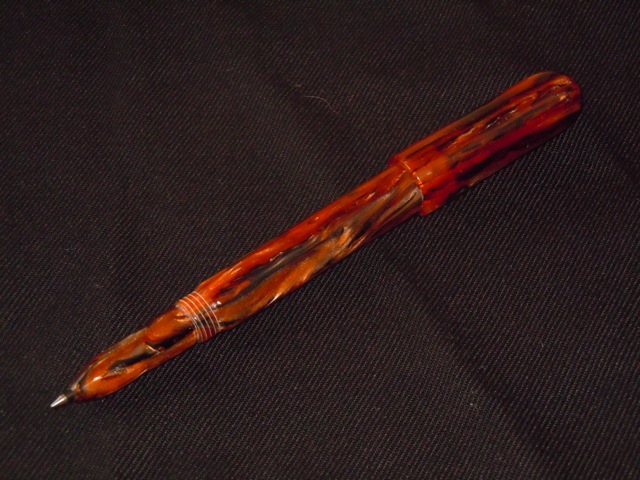

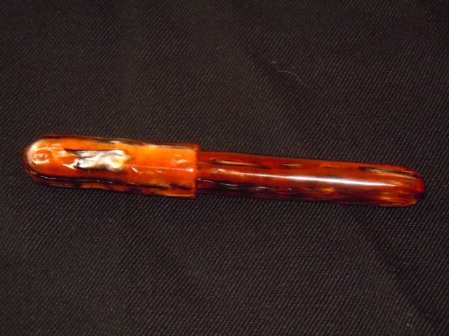

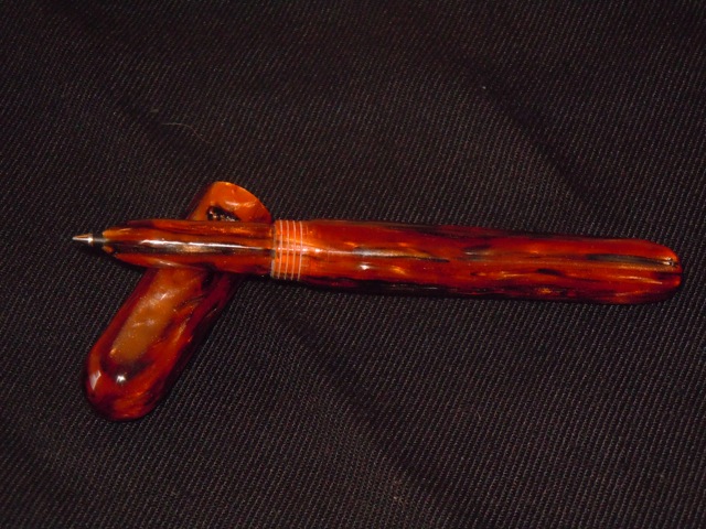

This was my first kitless that I made today. It took me four hours to make, by far the longest it has taken me to make a pen. The cap looks like it should thread on but I had to make it stay on with friction because I did not leave enough material on the writing end for the threads to work properly. I am very happy with it. All comments are welcome.

Congratulations on going with your first kitless pen and welcome to the outside of the box. Im sure there will be more to come.
Nicely done.....
Thank you
Congratulations on going your first kitless pen and welcome to the outside of the box. Im sure there will be more to come.
There will be more to come I had a lot of fun making this one.
Yeah, that looks really good. It also begs to be further explored and refined.
Thank you I will definitely be exploring with more ideas
...... I am very happy with it. All comments are welcome.
You should be happy with it, it's a nice start, a heck of a lot nicer than my first try!
