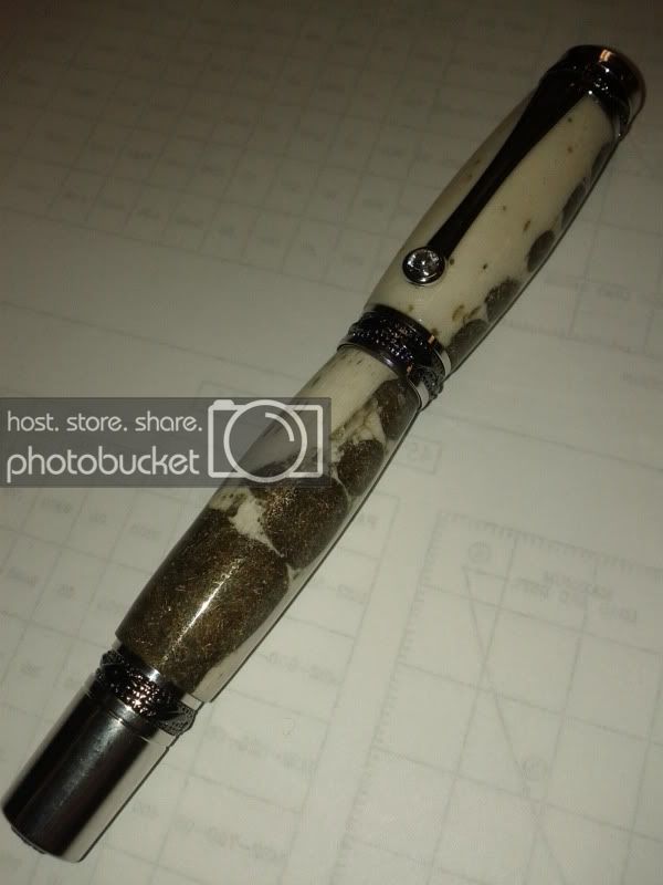

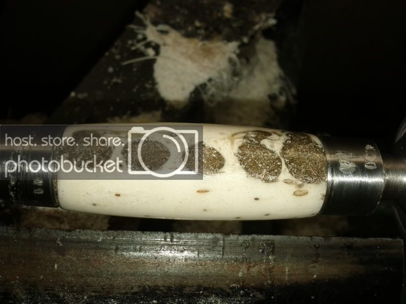

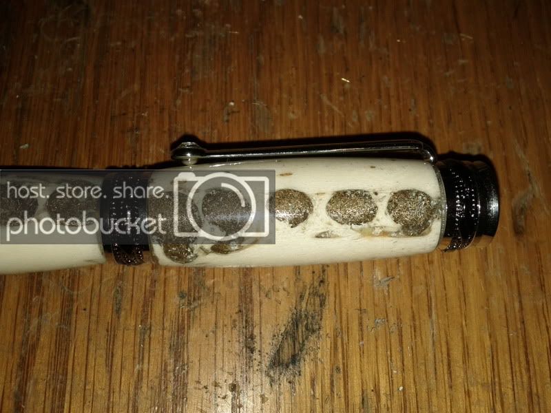

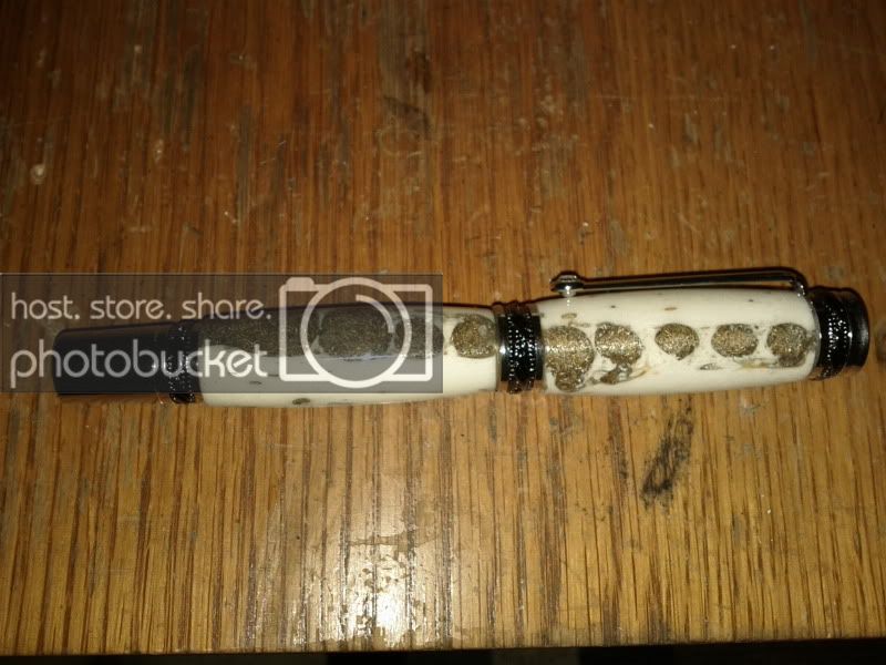

Ok guys, here it is. It's not my best work (especially the photos, i'll take better ones later), but I can say I have turned a gator jaw bone. I wasn't really sure what to expect with this, even after reading posts and suggestions. I do know what I will do differently on the next one and what I want to get out of it. This one, I filled with brass shavings.
All comments, suggestions and smart*** comments welcome.
Nic
P.S. There actually is a shine to the CA finish, but the cell phone pics don't show it off too well.
Filling it with brass shavings is very, very interesting and creative. Nice job!
So, hey! How'd you like that smell!? You'll never forget it.

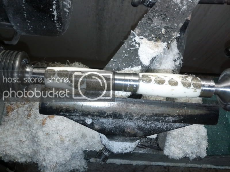

cutting it up on the bandsaw, not good. i got too close, and even with the mask on (simple painters mask), i started hacking up a lung. but turning it, for some reason there was no smell until i started sanding it.
and the brass shavings, i got the from wal-mart. a lady there let me raid their key making station.
Great dental work! That's a beautiful pen you got there!!

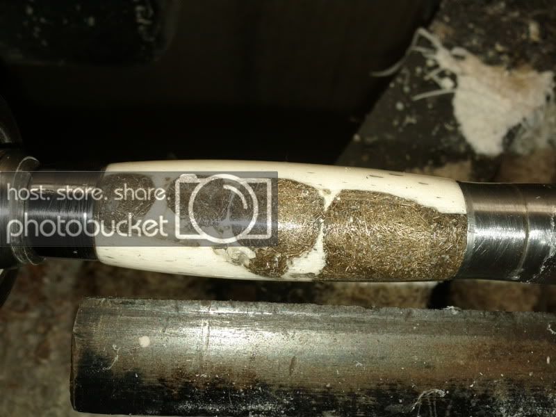

Turning and especially sanding gator jaw will generate a LOT of dust. One thing I would recommend is that you use compressed air and tooth brush to clean out the pits before applying a finish. That will eliminate those tiny white specks you see in the brass filings.
Tom
Nice results. I like the brass, I might have to try some aluminum on one :)

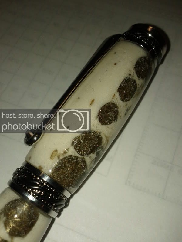

One thing I like about yours, the lower barrel. You took it down to show the sockets. Most times people from what I see, just go on a bushing. That leaves a lot of resin fill over the top of the sockets. I always take mine down and if needed build up with CA.
Very nice pen
Very nice.
Thanks Chris. I might have to get with you on the next one. I'm tempted to do a colored casting. I've only done clear PR so far.
