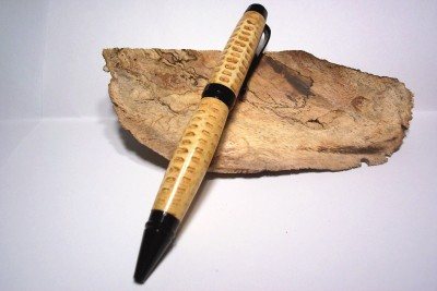

Fist corn cob. Turned out ok. Will be better next time.

Kind of hard to tell from the picture how it turned out.
One suggestion is try to have the camera parallel to the angle of the pen unless you are trying to make the pen look like the part closest to the camea is 5 ft. long.
Tripods are fairly cheap .
Another thing is to use the viewer on the camera to "frame" it and use the timer so there is no "shaking" when you "snap" the picture.
try also taking the picture with different settings, flash,/no flash, resolutions,natural light .
when you down load the picture you can look up the properties and it will tell you what you used and you can try to use those setings on the next pen pictures you take.
I have found if I take a picture in the highest resoltion I am able to with my 2 meg 2 yr old Kodak,I can resize it easily with "resiz pictures" from windows power toys.
I am not a good photographer by any means.But I do try to take clear pictures depicting the final pen.
It seems the new fad to post pictures with pretty backdrops, sometimes different effects.
When a picture is posted I am more interested in seeing how the fit and finish looks rather than a "catologuge" image.
It's nice if you can accomplish both in the same picture but if I can only have a choice of one I would rather have a clear picture of the pen than pretty back drops.
After all, when posting a picture on this forum, the pen is the issue not the backdrop.
I'm not trying to ruffle feathers, just an observation.
