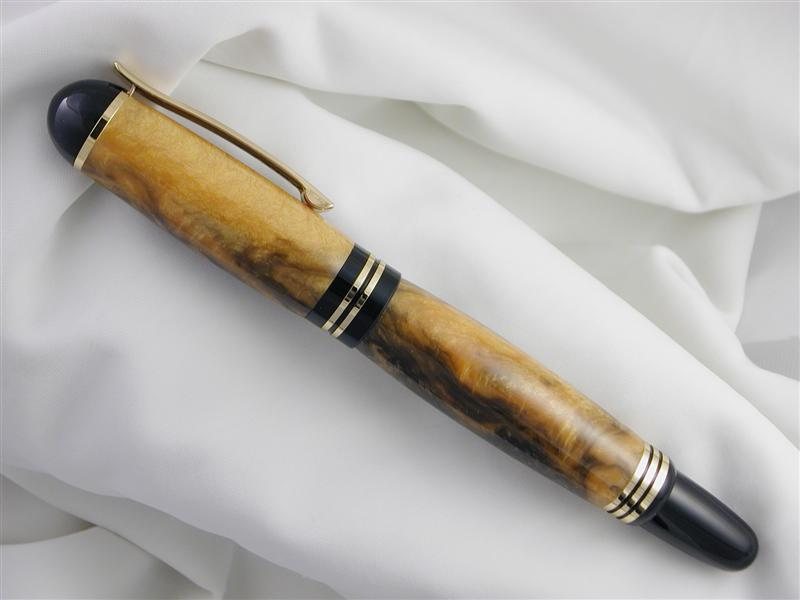

Well I did my first Churchill today and I do really like these new kits. Also the only piece that is plastic is the centerband. The other two pieces that are black that everyone assumed was plastic is in fact metal that they painted black. The material that I choose for this one the Gold and Black Inlace from Ryan, I like working with this stuff also. Thanks for looking.

Originally posted by wayneis
<br />Also the only piece that is plastic is the centerband. The other two pieces that are black that everyone assumed was plastic is in fact metal that they painted black.
That's right, the receiver tube and the cap finial are metal, that's where the extra weight comes in. I hadn't noticed! Glad you pointed it out.
Of course other plastic pieces are the threads and the section ;-) But those 2 pen pieces being metal is nice - I have broken one or 2 receiver tubes myself on El Grandes, dropping the pen in an unlucky way

Fred this material is actually an acrylic called Inlace and I bought it from Ryan at Woodturnz. Looks like wood doesn't it? Its really fun to work with but you do have to be pretty carefull with it as sometimes it can be kind of crumbly unless you take very light cuts. What I have been doing lately is putting a burr on the tool that I use and pull it through the cut, just the opposite of how we turn most materials and it works good. Then the finish and shine is really awsome.

Wayne, If I'd paid a little more attention the first time I would have seen where you said that in the description[:I]. It looks alot like some oak burl that I have. Still a beautiful pen.[:D]
<br />Fred this material is actually an acrylic called Inlace and I bought it from Ryan at Woodturnz. ... Then the finish and shine is really awsome.
I've been working with this material quite a bit lately and the finish you can get with it is amazing. You can see some examples of the sheen in my album. I call it Acrylester... Ryan actually calls it Inlace Acrylester. With almost all of the other synthetics I've turned I've had to use a plastic polish at the end to finish up. Not with this stuff. Just wetsand with MM through 12000, add a little Ren Wax and you're done! [:D]

This material has been available for years, but Ryan is expanding the offerings in many new colors. As Wayne says, it is somewhat temperamental, but the results are always outstanding. TRY IT! But expect some breakage, your mileage may vary.
