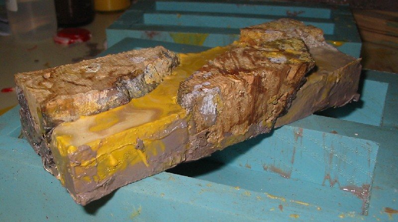

Here is a photo of what I am talking about:
I actually over-filled the mold and notice the significant shrinkage from 7/8" thick to this... (what this photo doesn't show is a nearly 1/6+" gap around the WW perimeter... I can probably trim it up and get a Slimline+ blank out of it... but I don't turm Slimlines...
