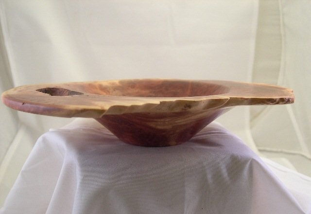

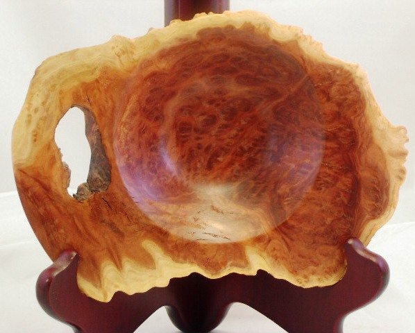

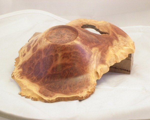

Ok here it is all done not bad considering I dont have a bowl gouge or a scraper. Had tons of fun. Also I decided not to carry the bowl up through the wings, I will wait till I get the right tools.

If you don't have a bowl gouge nor a scraper, what tool did you use?
This is the description of the tools I have. (FOR NOW[:D] )
Our 3 piece Pen Turners set includes a specially designed 3/8" shallow gouge, 1/2" skew with rounded edges to prevent marking the tool rest and a 3/32" narrow-kerf parting tool for maintaining proper grain alignment. Supplied with 8 1/2" handles.

Thats what this was too if you look at the end with hole in the wing you will notice the rounded non-natural edge part well thats where I cut it in half.
