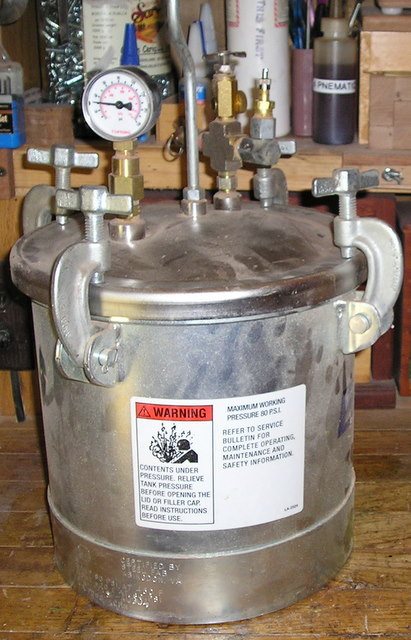

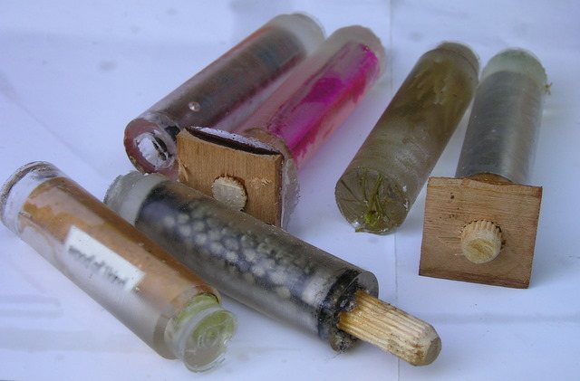

I been collecting and making casting supplies just so that I could reach this point today. Finally got around to casting my very own PR blanks. Here's some of the 'goodies' that I use...

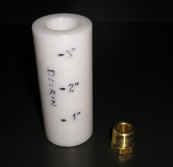

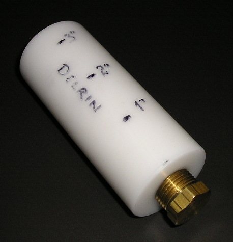

Delrin 'pots' incuding holder
Binks pressure pot

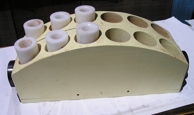

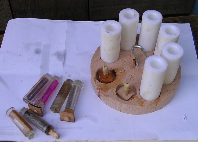

Pressure pots and extracted blanks
6 pots = 6 blanks :D

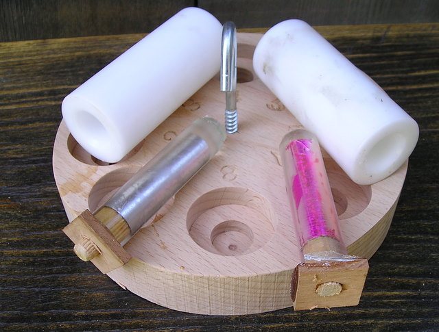

PR blanks close-up. TBT (to be turned) later ;)

Close up of my delrin version with 'easy extractor' brass plug. These are made to my design specifications in my uncle Mike's machine shop.
