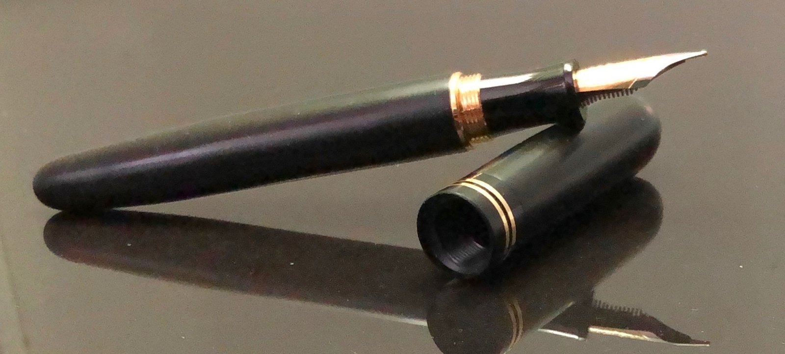

Here's a Churchill Fountain pen with closed ends, my first try at going beyond a standard kit. I cast the blanks from alumilite and used the center band, tubes and fountain pen guts from a Churchill kit. I measured everything and drew it out, including drilling depths, which despite my care I still managed to screw up. I made little jamb chucks from hardwood dowel and turned the closed end blanks on a collett chuck. Either my drilling was a bit off or my jamb chucks weren't completely centered or square, but the drill hole was slightly eccentric at the far end of the barrel, and as I shaped the end I cut through to the drilled out center. I was tempted to throw it all away and call it a day, but instead I cut off the damaged end and glued on another piece of blank. I turned it down to match and it came out great; I can't see the repair at all. Getting a halfway decent finish was pretty hard, and I'm not very happy with the finish on this, but I'm tired at this point, so I just put it all together and it came out looking pretty OK. Because of the eccentricity on the jamb chuck, I had a hard time getting tool marks out and getting a homogeneous finish but eventually got something that isn't too bad (wet sand 400 & 600, then Novus 3, 2, and 1). Please feel free to criticize and make suggestions!

I think you deserve a lot of credit for this accomplishment !!! . It is quite a major undertaking to go from a standard kit (using mandrel & bushings, or TBC) to a closed end design (with improvised lathe mountings).
You have done a remarkably nice job, in my opinion !!! . Congratulations !!
This is a big step in the transition to kitless !!!

I might add that, to get tool marks out, I find it helpful to use a fairly coarse automotive/boat cut-polish between the sandpaper and the Novus.
There is quite a big transition in going from 600 grit to Novus 3. . I usually go up to 1500 grit and then use the cut-polish before the Novus 3.
I am not sure where the optimal transition is; I have a feeling it is below 1500 grit. . However, the Novus 3 seems to take over well from the cut-polish the way I have described.
Also, I am not sure about the coarseness of the cut polish. . I use a Mequiar's product. . I can get you the product name if you wish.
EDIT: The product has the number 49 prominently on the plastic bottle and it is called Marine and RV Oxidation Remover.

Thanks very much. I think I really surprised myself that I was able to pull this off, but the help here is phenomenal and the tutorials, etc. are really great resources. I am certainly cultivating a lot of patience with this art!
I love fountain pens (it's ironic that as a lefty, I can't really write with them without smearing ink everywhere), and I'd love to get to the point where I can go fully kitless.

I think this is great for your first attempt! Cut yourself some slack and call it a learning experience, just like we all have to learn any new skill.

not too shabby can't find any flaws. i would be very pleased if I produced this. did you use the lives center to stabilize the rotation?

That is a very attractive pen. I know every little flaw in my work, but I'll say what I've been told: "The flaws are not apparent from the pictures"
Well done. I suspect the learning curve for this was very valuable. Thanks for sharing your journey.

I did use the live center, but I probably parted off the end piece too soon because I had to do all the final end shaping and finishing steps with the end unsupported. I'll try to get more of the shaping and finishing done before parting off -- live and learn (and boy did I learn a lot with this one).
