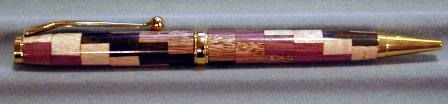

Thanks to Kenn Osborne's article, I tried making a segmented pen. It's a Comfort pen without the grip in Purpleheart, Birdseye Maple, Peruvian Walnut & Mahogany. Pretty happy with this one but I probably need to sand a little better for the next ones.
Working on a couple more patterns and combinations of woods.
Seeing all the wonderful pens and ideas displayed here is quite inspirational. Thanks to all who share!

The first thing I noticed was the colors and the finish.
You did a great job.Mixing PH, Walnut. and Maple isn't easy without staining the maple.
Nice contast in woods.
I just saw this pen in the photo album and was hoping you would post a pic in the threads. Very well done. I have been contemplating one myself but I was worried about bleed from the colored wood to pale woods. Did you have any problems with that? BTW great job!
Very sharp looking pen Paul. Great job for your first attempt. How much time do you have in the cut & glue up? Anthony
Thanks all! As far as bleeding, I think I was more lucky than good. I remember reading an article somewhere (WTD?) about how maple and purpleheart are compatible in segmented designs so those two were easy and a nice contrast. I went with the Peruvian Walnut and Mahogany mostly for the coloring.
I did it over two nights. First day I cut the strips and glued them into one stick. The next day I cut the squares and glued those up. I let the glue dry over night. The last day I treated it just like a regular blank. I'd guess maybe 20 minutes to a half hour each day to get the blank ready? Maybe a little longer on the 2nd day since there's more little pieces to sand. It definitely wasn't a long time.
I have a checkboard blank all set to go today. That's Cypress and Peruvian Walnut. A Curly Koa and Bloodwood blank is half way there. It's been fun seeing these come together.
Thanks
I turned the checkerboard blank last night. Learned two things. First, Cypress is a little too grainy or porous and stained a lot more than the maple did. Second, I have to work on my turning technique now that I have a Wolverine setup. My tools cut A LOT easier now. I definitely have to lighten my touch. Ruined the lower barrel by taking too much off by mistake. Hopefully the Koa/Bloodwood combo will work better.
Oh fer two last night as I thought I had repaired a crack in an upper barrel for a Ligero but after turning it, I can see the brass through the crack. <sigh> I guess Murphy's making a stop by my shop now.
