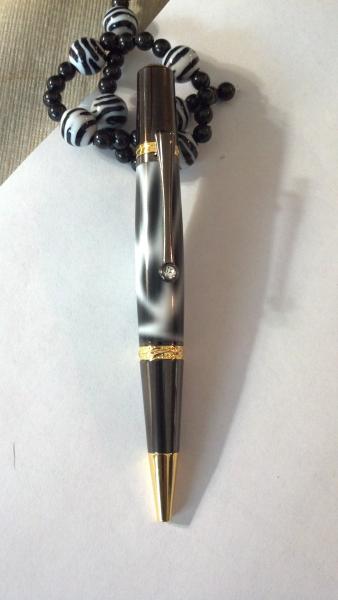

Decided I better get my feet wet doing Acrylic since I have a couple of folks interested in the lepoard blanks I have.
Turned this today for the wife, I had the edge chip out down a hair below the bushing when I was just about done turning.
I fixed the chip out by dabing a little drop of thick CA on it and hitting it with accerlator before it had a chance to run, kept doing that until I had it built back up above the bushing; then finished turning it.
I need to work more on my sanding and polishing but all in all it didn't turn out too bad.
What do you all think?
All comments good and bad welcome. Gotta learn some how.
Thanks
Danny

Good job on your first! Acrylics can be tricky. Best to take them slow so they don't chip, but I guess you figured that out! ;)

Advice on turning acrylics, from my experience FWIW:
1. Keep your tools mega-sharp; I've caught embedded ribbons and other segments on dull-ish tools more often than I'd like to admit. The entertainment value of watching the pieces arc across my shop for a split second is quickly overshadowed by the despondency of losing an awesome blank.
2. I've had more luck using a round-nose scraper after knocking the corners off with a gouge than I have turning the material down any further with the gouge itself. Most of my chip-outs have happened because I relied on the gouge for too long in shaping any given blank.
3. Wet sand when using the Micromesh pads. They do (almost) fine dry but creating a slurry by dipping them in a bowl of water first seems to eliminate about 75% more micro-scratches for me.
4. Come up with a slick excuse for when you forget to paint/blacken the tubes and they show through. Personally I like this one: "Check it out...I was able to highlight some of the 'gold' from underneath the acrylic--look how it accents the gold hardware!" (disclaimer: this only works on non-pentuners)
Hope this helps!!
Thanks Guys:
I still have a lot to learn, mainly on finishing I need to sand longer with each grit, I know not to use the dry finishing pads they don't work.
Thanks for the tip on switching to the scraper, I was using the gouge when I chipped the corner, luckly it wasn't too deep and I was able to fix it by building it up with CA.

I have found that a water spray bottle while wet sanding has really helped me out. It is actually not that messy & does a great job keeping the sandpaper nice & clean. I do lay an old towel under the work piece. One other piece of advice that I got from someone on this forum was to make sure that all of the scratches from the current grit of sandpaper that you are using are all gone before you switch to a finer grit. I know that this sounds elementary, but sometimes I would get to end of my sanding & find one deep scratch that I had missed & then would have to start over. :mad: And finally, if you want your acrylics to really pop, get yourself some Micro Mesh (MM). It really makes a difference especially on the acrylics. Good luck & have fun!!!! :biggrin:
