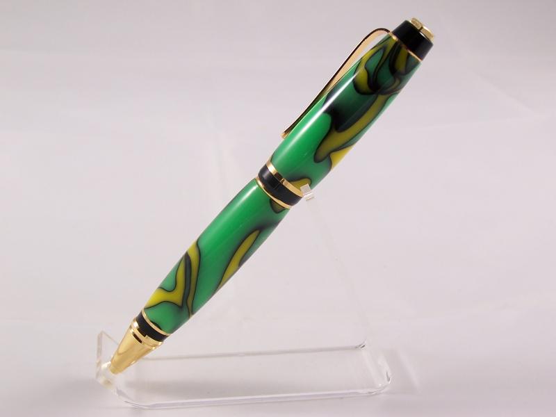

First Acrylic with new advice.

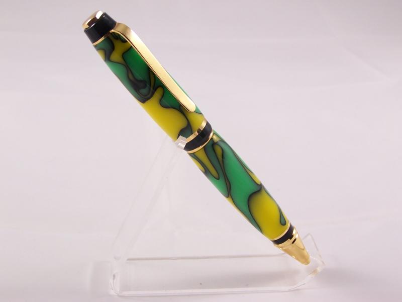

This is a pen i justed turned to see if turning up the speed on my lathe helped me turn acrylics easier, i guess it did it took me 1/3rd of the time to turn this one. I got this AA blank from woodnwhimsies. It is a chameleon blank, it think it is pretty cool. I turned this with 1/2 bowl gouge and 1/2 skew turned at 3100 rpm. after turning just went straight to mm. mm to 12k then polished with hut plastic polish that i forgot to shake up at first(i do this alot). Thanks to Ed and alphageek and rubypenturning for the advice!

Very nice, good choice of material (AA) for learning.
Keep turning, nothing beats experience!!
(Keep eyes covered!!!)
Excellent .... Glad you got good results so quickly with the feedback. Keep up the great work.
You went from skew to MM? Excellent job - that tells me that you don't have a problem sharpening your skew and have excellent control of it!
