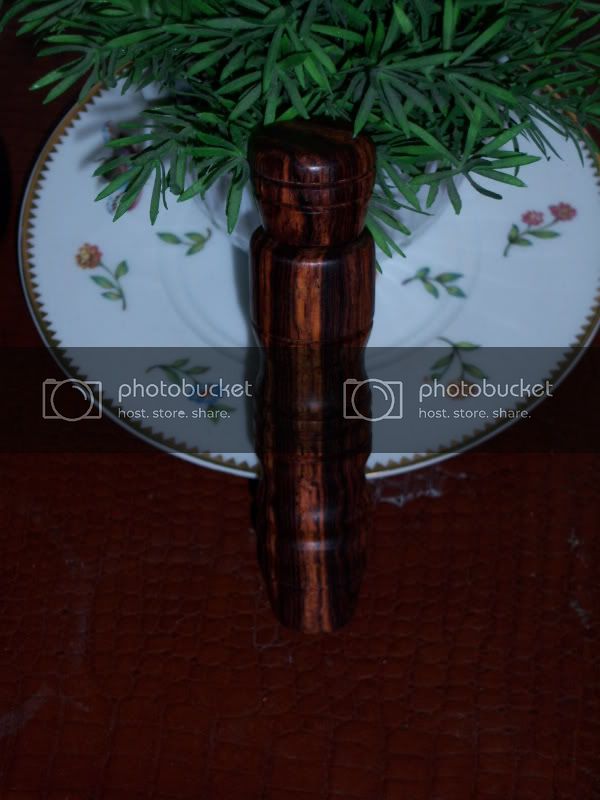

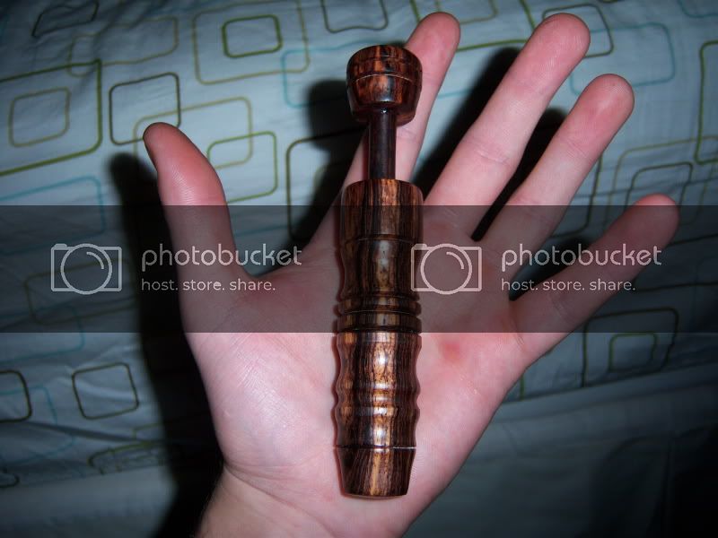

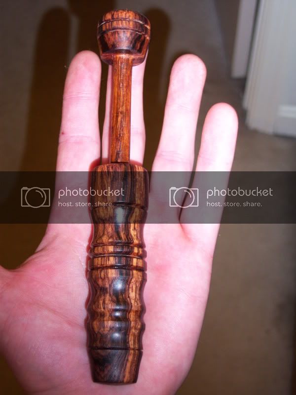

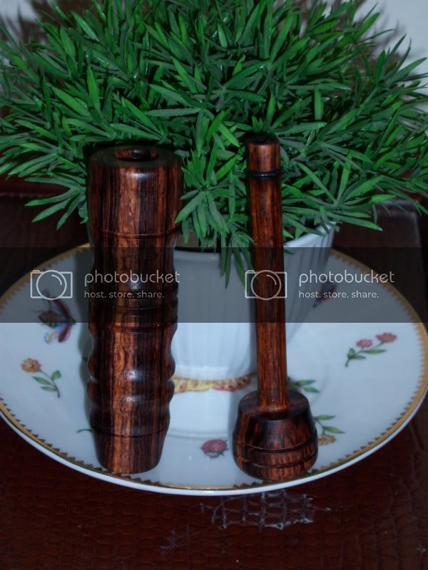

Hey guys, Just wanted to show you guys how my first fire piston turned out... Made it out of a beautiful piece of cocobolo. I am new to the lathe so I experimented around with coves and grooves and such. Let me know what ya think!
It creates an ember by compression. You put some tinder in the end of the actual piston part then slam it in the hole and pull out, thus heating up the air which turns the piece of tinder into a smoldering ember to start a fire.

4. From the pictures, the bottom picture looks like the piston is a very dark color. Are the pictures of the same piston or did you make multiples.
I realy like the coves and grooves, as I think that it not only makes the piston look good but it gives the person using it a better grip. I have read articles from people that use these and often times they complain about not having the grip.
Can't wait to see the video.
Very nice job!
Dan
Dan,
The hole is 3/8" wide and I drilled it about 3.5 inches in and left about .5" on the end to prevent blowout. I made the actual piston a little larger than 3/8" then sanded it down so it barely fit in the hole. This is the most important part of the process. Also make sure that the piston itself is less than 1/16th of an inch from the bottom of the hole when inserted, anything more will not generate enough compression. All the pics are from the same piston. Hope that helps!
