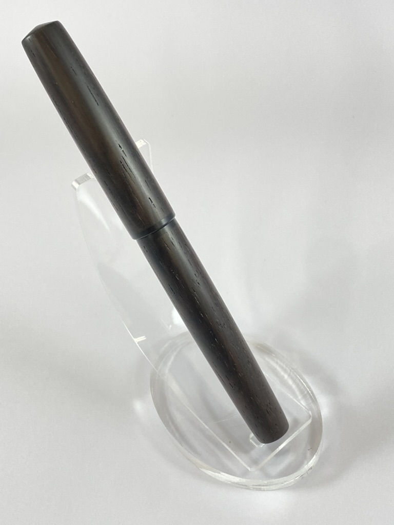

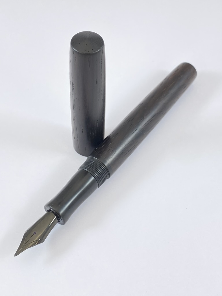

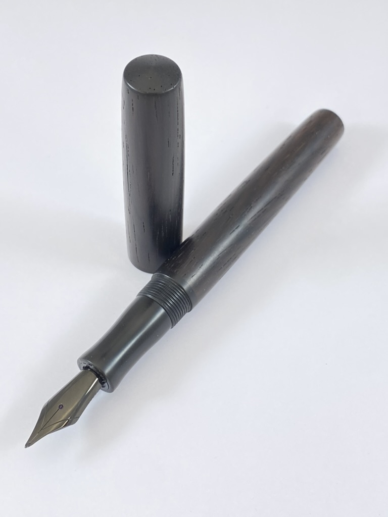

Here is an example. The wood is old growth true Brazilian Rosewood (Dalbergia Nigra). It is very hard with a Janka Hardness of 2,790. The cap and barrel are completely lined with Black Nikko Ebonite. The section is also Nikko Ebonite. There is no finish on this pen. The ebonite and wood is sanded to 800 and then with a 1500 Mirka MirlonTotal pad. IF the wood looks dry in some places, I will use a very small amount of walnut oil, like single small drop, on a microfiber cloth and rub it into the wood and then wipe it off.

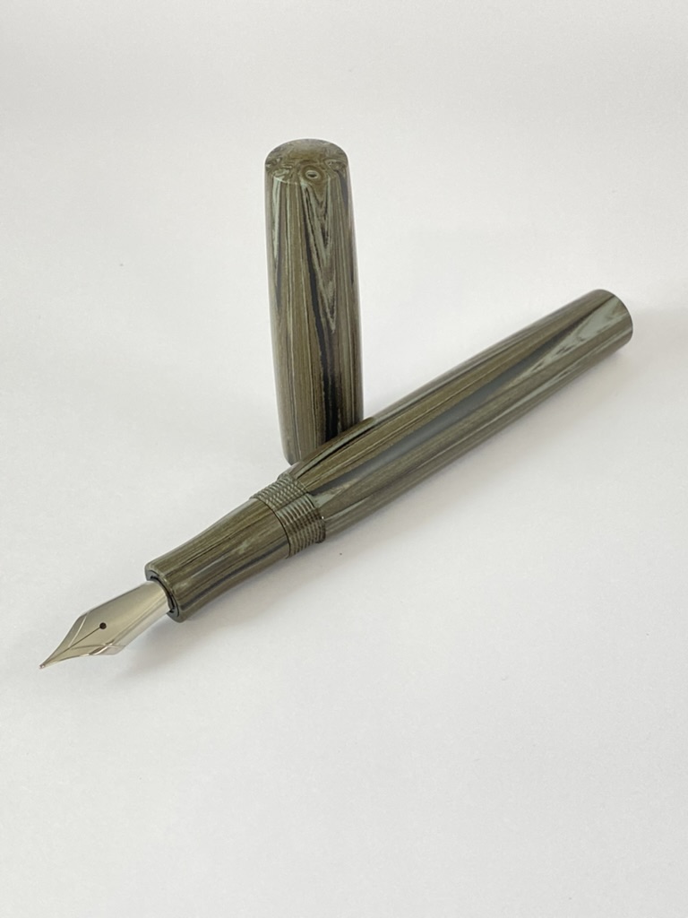

I realize that these two pictures don't give you much of a look at the ebonite in matte finish. So to give you a better idea what your finials might look like, here is another pen that is all ebonite and all in matte finish.
