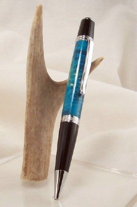

Stabilized wood is not homogeneous. Although it generally can be polished to a higher sheen than non-stabilized wood, you will not be able to achieve a glass-like surface (if that is your goal). The blue boxelder burl Sierra is finished with CA.
