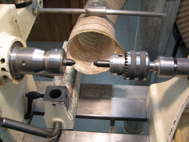

You don't need to go to all that trouble. Just put a point on some Delrin and use it as centers...
attachment.php
I have a revolving drill chuck in the tailstock.
That's a good idea, BUT, I find that it's much nicer and faster for two piece pens to be able to apply CA at the same time. And it doesn't take that much longer to drill a hole in the delrin so they fit on a mandrel...
