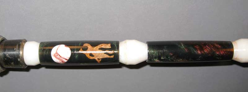

I used black tubes ... not sure what that line is in the photo... I can't see it on the pen??

I would actually not have power sanded the blank. I would just spin the blank, then lightly sand by hand to even it out in case of any chisel marks..just with 220 grit. Power sanding on wood has the potential of burning the wood, and because you have a mix of wood and plastic, the plastic might sand more than the wood, or vise versa, leaving a ridge between the two materials. so just a light sand with 220 would be fine. this will also give the ca a good sticking surface. If you sand plastic too much, the ca can not stick so well. The resin is alumilite, and will take a ca finish beautifully. I would also apply a ca finish to the lower barrel if there is one, and this will make both sections have the same shine.
Pen photo looks great...I hadn't seen one of these spun before, and I like it. Once a ca finish is applied, why wouldn't you wet sand it? the water will not get into that little piece of wood when it is covered in ca.
