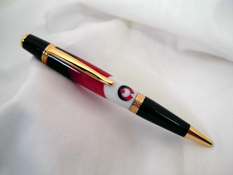

Followed all the advice and have attached a photo of my sample. Not perfect yet but not bad
Thanks again

I have made numerous pens with decals. On the first ones I done I had the same problems as you. I start with 3-4 coats of med. Ca followed by micro mesh. The trick I have learned is letting the decal cure and the ca cure at least 24 - 36 hours. I have tried using accelarator but its not the same as letting it cure on its own. At least for me. Its just like anything else in penturning, you gotta find what works best for you.
