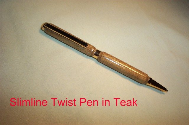

Here's a few that I finished up this week-end.
This is just a Slimline in Teak

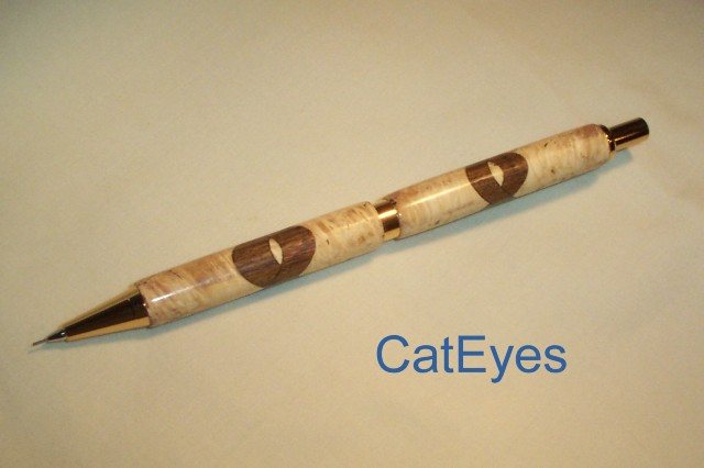

This was an experiment - I call it "Cateyes"

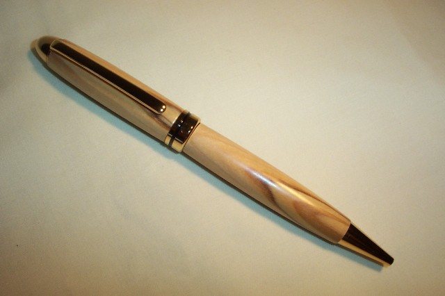

This is the first European Twist Pen I've done - I had an interesting time figuring out the bushing set-up. This was the last piece of Olivewood I had on hand.

I'm amazed that the "Cateyes" has gotten so many comments. It was an experiment just to see if it would work. It's made from Maple Burl, with Wenge cross accents. (Scraps I had in my blank box)I almost threw it away when I got it done.

I like the slimline. I usually don't like the corset look on slimlines but that one is well done using the convcave curve. I will have to try that one. The others are great as well. Classy european setup.

Lou - I think I owe most all of it to the MM I started using. The top slimline was finished with the Deft spray laquer on the lathe. The Cateyes was finished with the Deft, but hang sprayed, and the Olivewood was just finished with good ole' furniture paste wax. I've yet to try the Blo/CA finish. I'm just not brave enough to try it yet. I envision massive stuck bushings to mandrel, etc! - The cateys were cut in using 2 45 degree cuts. I cut the blanks in half at 45, and glued in the first accent piece, and glued the blank back together. After they dried, I again cut them at 45 right through the first accent piece I put in, then glued them back up. That's all there was to it.
