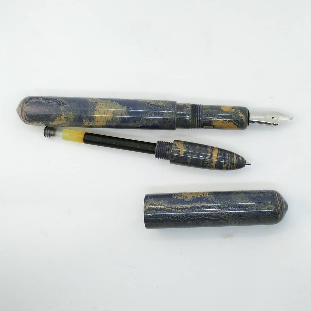

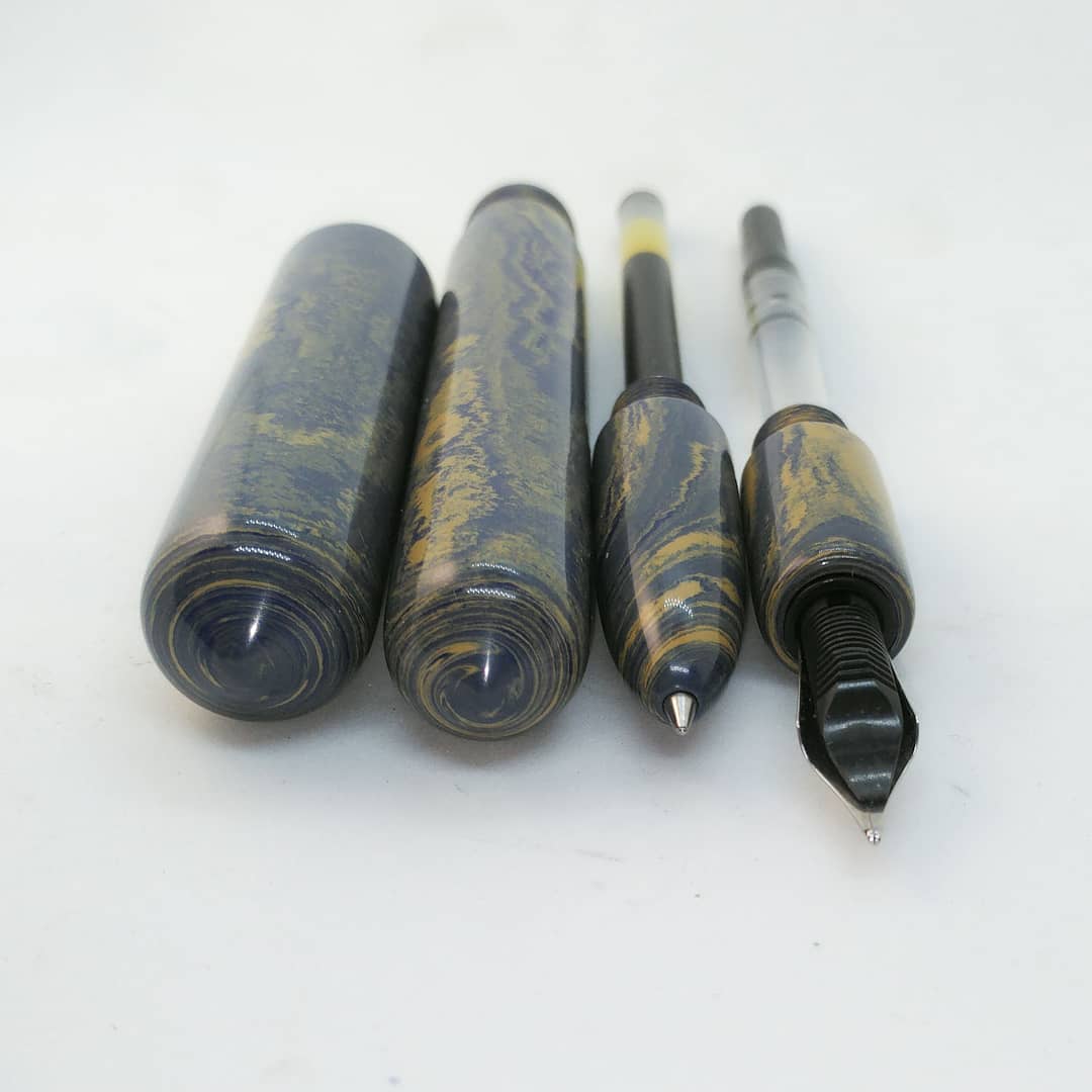

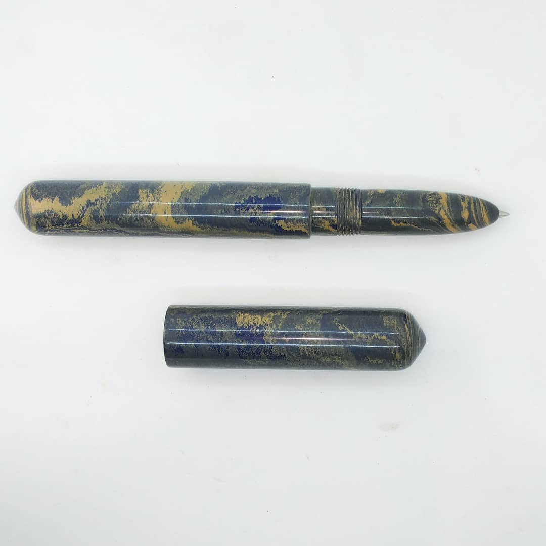

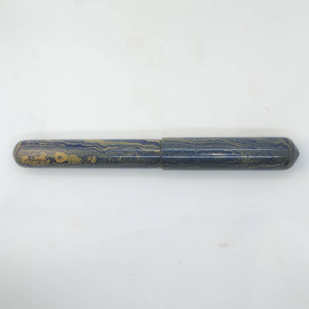

Here are 2 kitless pens I completed recently,
First is a blue and white ebonite that has a FP section with a ss Bock #6 and a section for a Pilot G2.
Tap/die for cap to body is M14 x 1.0, section is M10 x 1.0
Around 155mm length total
Body 16mm
Cap 17.75mm

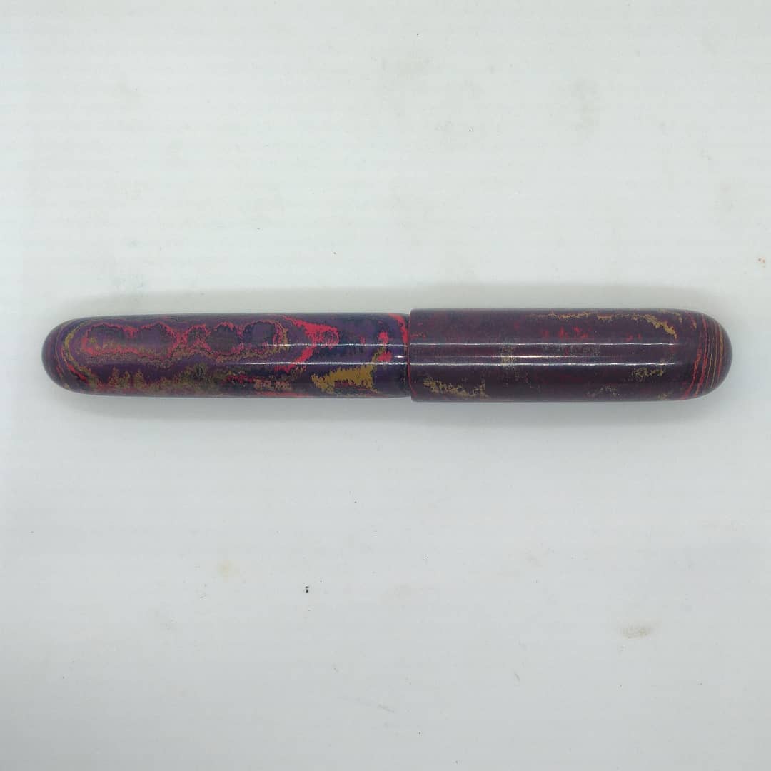

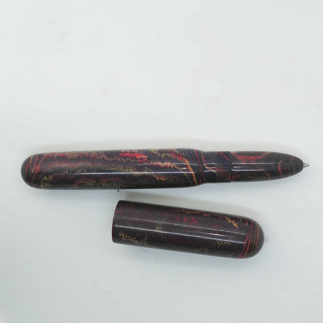

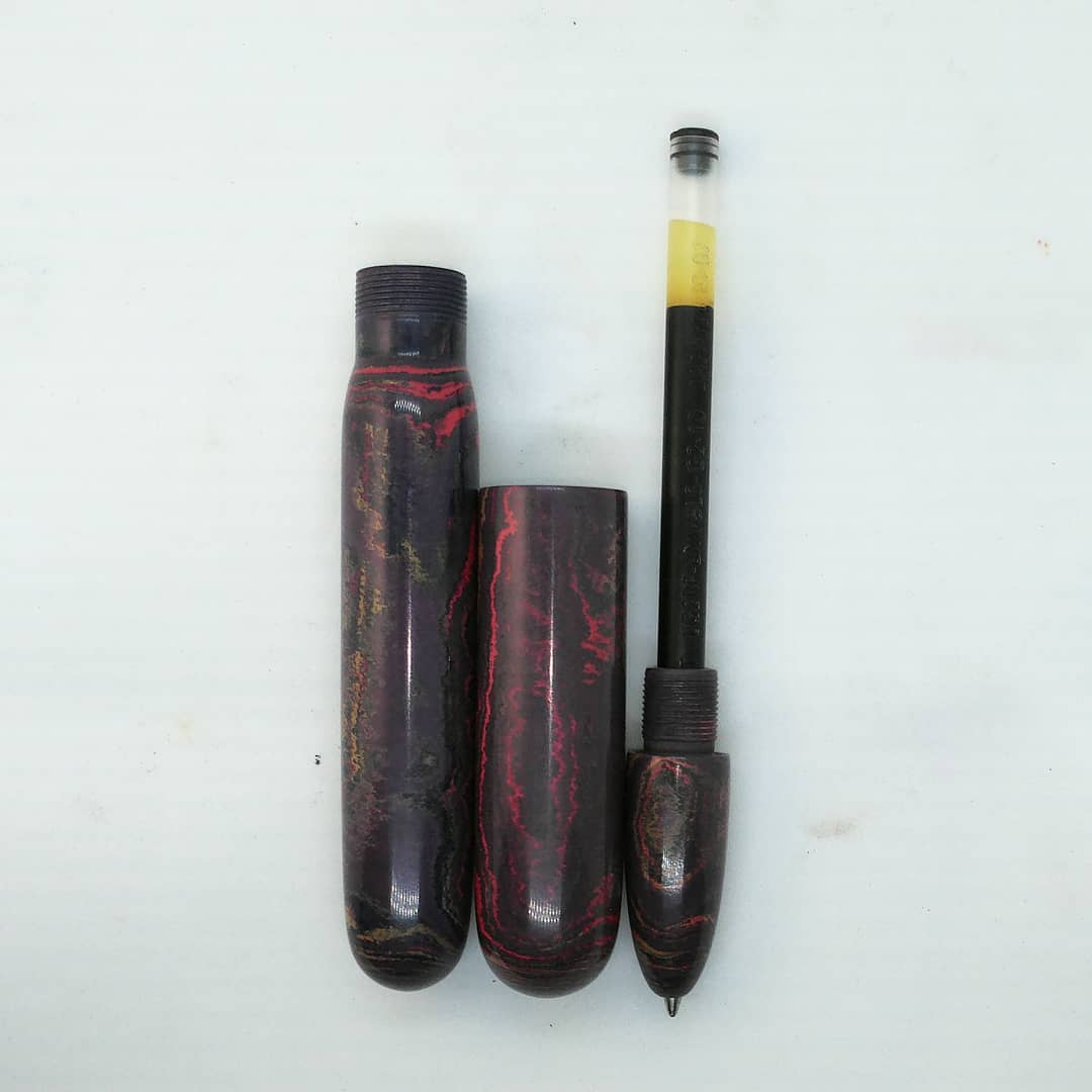

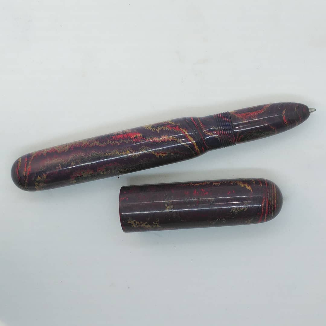

Second kitless is purple,red,white swirl ebonite
that uses a Pilot G2 section.
Tap/die for cap to body is M14 x .75, section is M10 x 1.0
Around 135mm length total
Body 17mm
Cap 18.5mm

Both very nice !!! . I really like the colors in the purple, red, white swirl ebonite
As a stylish feature, I like the bolder M14 x 1 threading.
I also like that it can be both a FP and a ballpoint ( gel ).
Well done, Russ ..... thank you for showing !!!
