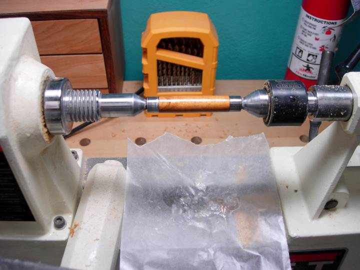

Just thought you guys might want to try this. It is a re-post just in case some of you missed it.
I do my final sanding and turning without a mandrel and turn between centers.
It is very simple really. Mount a dead center at the head stock and a live center at the tail stock. Turn between centers with the bushings still on the barrel.
That is it!!!
I saw it on the pics of the fellow member and I though that should work...no deflection no getting out of round....SIMPLE, CHEAP, and EASY. What else can I say?
I will try to post pics next week. I am out of town until Monday.
NOTE: I still do the rough turning with a mandrel. But care less about deflection and it being out of round. I fix that during the final sanding and finishing.

How does the headstock center alone grip the blank solid enough to be able to turn it?
I have done what you are talking about with steel bars on a metal lathe, but you can apply enough pressure with the tail stock to the bar for the center to grip it enough to hold.
Bonefish
It works with plain friction from the dead center to the bushing.
As I said, you still have to rough turn with the mandrel. Believe me, it works.

Thanks, that's an interesting idea! How do you ensure you've aligned the blanks/bushings in the center of the live/dead centers? Even a slight misalignment can cause the same kinds of problems we experience with the mandrel.
Dario:
When I asked about holding the tubes on the dead center, I didn't see the part you wrote about leaving the bushings in the tube.
Now, I can see how it would work.
I pictured putting the brass tubes over the dead center. I didn't understand how you could do that without belling the brass or spliting the blank.

<br />So if I understand how this works then this technique would not work on slimlines. Only those where part of the bushing sticks inside the tube. Interesting.
Corey
Correct, Corey. This wouldn't work with any pen that doesn't use "step" bushings. That also includes any "B" style kit that has straight bushings (like the bottom tube of the Perfect Fit).
As Corey and Billy said...I am afraid I haven't tested this on slimlines or other styles without step bushing. Not sure if it will not work on those but I am afraid it might break the wood once pressure is applied straight to the tube.
If anyone cares to experiment on this, do let us know your results [;)]

I can see where this would be a good way to go and I even went out and mounted a cigar top up and like the firm feel. I guess a guy could turn his own bushings to fit all his kits and make them step bushings. I know my PSI mandrells give me some out of round pens. I wonder if it would help to just adjust them to turn one barrel at a time. Seem better than nothing. I don't get that problem as much with my Berea systems which I have 2 complete setups with A and B rods. Anyway, thanks Dario for this info.

Hint; You don't need mandrel at all if you use sander to do a little rounding on the blank before mounting. And you CAN mount both top and bottom of barrel on centers at same time. I find pic later to show you how, or write description if I cant find pic.

Hey, this is the way we were turning pens before there were mandrels and separate bushings.
The closest thing to a mandrel was a 7mm piloted drive with a built-in bushing diameter that fit into a Jacobs Chuck in the headstock, and another for the tailstock. Brad Packard still had these in his catalog up until a couple years ago. They disappeared for lack of interest. I think I bought the last 2 that he had. I like to use them with the stepped bushings for larger pens because there is less vibration than with the long mandrel.

A lathe dog is used (mostly) in metal turning to provide drive power to a workpiece suspended between centers. It is basicaly a clamp of some sort that firmly grasps the work piece and uses an extended arm that is secured to the driving shaft. Methods vary depending on the lathe and workpiece. Unlike with the pen barrel trick, the dead center in the headstock does not provide enough friction to drive the work piece. So the dog makes a firm connection while relying on the dead center for positioning only.
I look for pictures of turning two barrels at once but looks like I will have to describe it or draw it out. I will make that another post.
