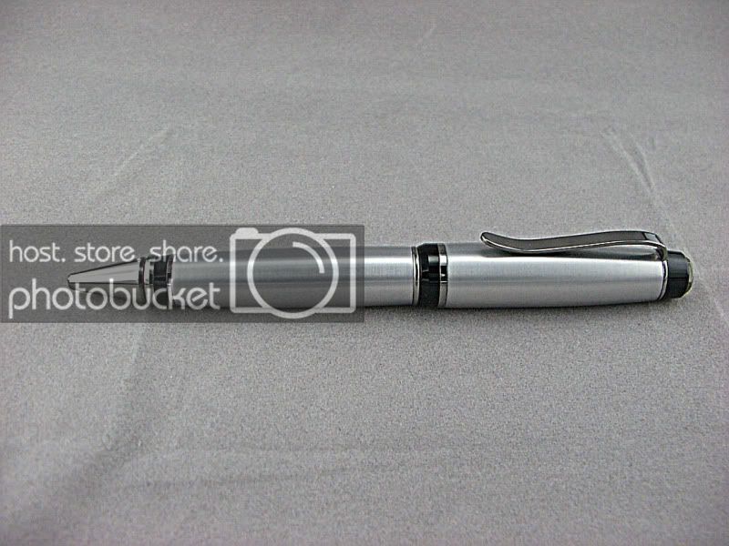

Here is a pen I made about 6 years ago and is an every day sit on the desk pen. It looks the same as the first day I spun it. It is all aluminum. I left it with a brushed finish on it. Some places it may show a little wear and has become shiny but did not tarnish or dull in color. just my thoughts.
Thanks John the pen looks nice. It may be just me. Thinking the parts need some sort of hardening. I've seen/noticed some of the parts I've made have somehow gotten faint marks on them. I may have to either leave them alone or, anodize the.
