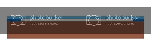

Syke--can you feel a ridge or bump after the CA has been built up somewhat? Otherwords, can you feel or see the transition where the item is placed? Is it best to have it go completely around the blank? Don't wanna steal Scotirish's thread but these questions may help him. If an item wrer placed only 1/2 way around the blank, how would you build up the other 1/2 to make it round? Probably have to be double cast?
I can feel the cigar band on mine. As thick as CA feels, a sticker or piece of paper is pretty thick. You'll have to at least double the thickness of the paper in CA in order to get everything even.
The brown is your wood.
The white line is the sticker.
The blue to each side of that is the first layer of CA that brings the sticker level with the CA on the wood. This makes the sticker seamless, but it also exposes the sticker to damage.
The blue on top is a sealing layer, which is the first and only protective layer on the sticker.
That's the way I would have went had I spent more time with it. Problem is, when you're getting that first layer down, you need to make sure not to damage the sticker.
