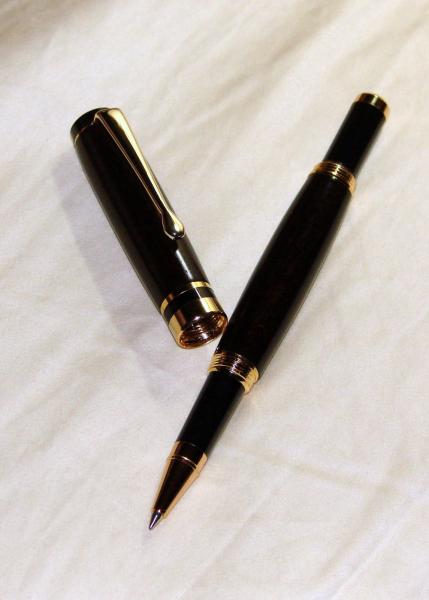

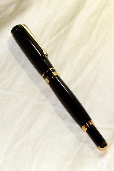

The pen is done, Here's a few pictures.
Thanks again for all the help.
I used a lacquer and wipe on poly as a finish.
