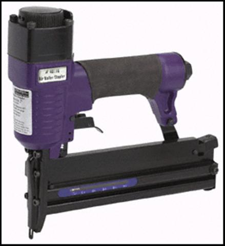

I bought a very inexpensive brad/staple nailer from Harbor Freight. Under $25 if I recall. The brads work well. The staples are rather narrow but long. There are probably lots of better units at the big stores but for the price it works just fine.
http://www.harborfreight.com/cpi/ctaf/displayitem.taf?Itemnumber=40116
Double-duty gun handles 18ga staples up to 1'', brads up to 2''. Patented.
* Single sequential safety trip mechanism
* Depth adjustment for flush or below-level
* 360° exhaust
* Magazine viewing window
* Fastener length: 1/2'' to 2''
Magazine capacity: 100; Operating air pressure: 60 to 100 PSI; Air consumption: 4-6 SCFM; Air inlet size: 1/4'' NPT
ITEM 40116-6VGA
$16.99 ON SALE NOW
thanks for the info bob. strangely, i had just finished looking through the HF catalog when i read your reply and was considering that one to start with. can't go wrong (well, i guess you could) for that price. :)
Actually you can go wrong with that one. I've been through 3 HF nailers. None of which lasted. Dont get me wrong, I am a fan of HF, but the nailers have issues with triggers and o-rings going out. You can get a decent quality nailer for 50-100. I paid 70 for an 18ga. Bostitch that has shot 1000's without issue. Also the type of work your going to do will dictate the size. 18ga will cover most work that is lightwieght or has glue helping it hold. For more structural stuff 16 or 15 ga work better but leave much bigger holes to patch. 18ga holes are pretty small.
Pass on a trick here, I put pieces of blue masking tape where I was going to shoot a nail. The wood was pre-finished. Then I was able to apply a color match putty. Worked great...
I have a Porter-Cable compressor set from Home Depot with the 5 guns. It has the 23ga pinner. That is slick. The pins need an arrow to show load direction. Hard to see the holes...
As a former field service rep for StanleyBostitch, pardon my prejudices, but was glad to see Scott's post above. Its true, folks, you DO get what you pay for. Having said that, no matter what type pneumatic stapler, brad nailer or nailer that you buy, GET THE PROPER OIL FOR IT!!! That is PNEUMATIC tool oil [NOT AIR TOOL OIL!!] and absolutely not WD40, both of which will destroy your O-rings in short order! If you have any in-depth questions, don't hesitate to pm. Good Luck!
I have HF 18 G 2" that is over 5 years old and never had any trouble with it. Have the HF staple gun 1/4" x 1 1/2 " for over a year and no trouble. A drop or 2 oil in air inlet every time I hook them to the air hose. Would do it again if they die.
