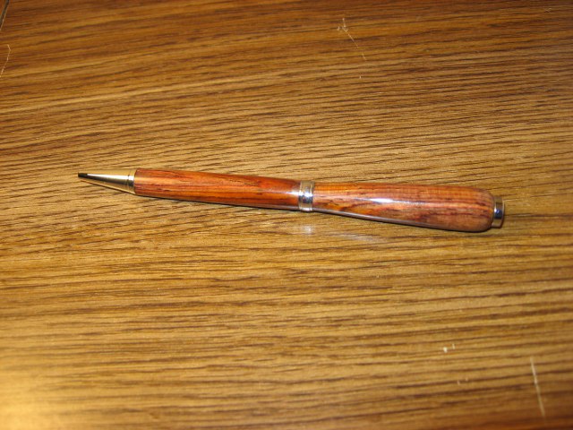

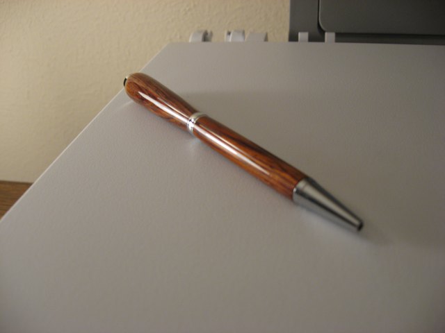

I turned my 6th pen tonight and the CA seems to work for me. I like using the BLO on the CA it seems easier to get the CA smooth. One key thing I found for myself is that you have to be fast when you swipe with the CA and one pass only at a time then I put the BLO on just as fast as I can pick up the paper towel. When I buffed this out tonight it got really hot on my fingers. The shine didnt come till it got real hot. I used a liquid car polish it was all I had
This is my finish with the CA/BLO
