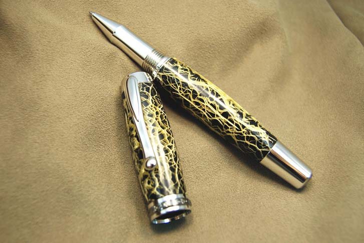

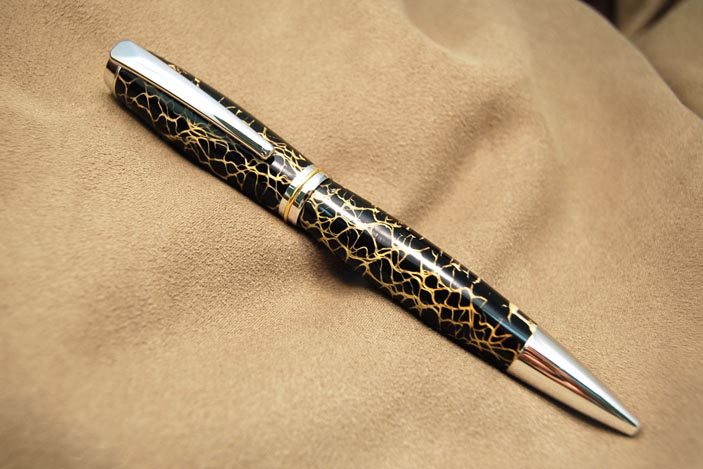

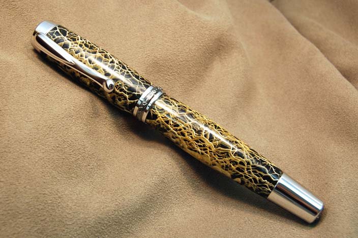

I finally got around to trying the cactus pens. These are some of Curtis' blanks and I am getting amazing response from them.
The first is a solid black Alumilite on a Jr Gents BP. The second is a Statesman with clear Alumilite painted black inside.

Once again, Chris, beautiful pens! I really like that Jr. Gent BP kit. You don't see it too often but it looks realy classy, especially with the cactus!

<br />I really prefer the clear but it does add a little more work to the process. The three dimensional quality is pretty amazing.
What work does it add to the process? Before I make mine into blanks, I'd sure like to know, so I make an informed decision about whether to put the cactus in clear or colored. Thanks!

When you drill the blank you have to paint the tube and the inside of the blank. Curtis paints the blank and then uses black tinted epoxy but I painted both and just used CA. It just means you drill and paint the night before and glue the next day.

G'dAY Chris your pens are fantastic mate' if l had to pick one l would pick the Statsman it show's off the cactus beautiful. Almost like its 3D Your photos and finish is also excellent well done mate' and we must thank CURTIS the pioneer of this unique material and also IAP for making it all posible[:D]
