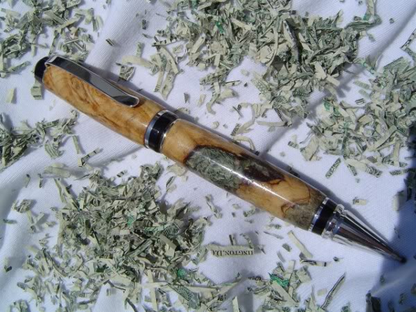

hey red, for this buckeye burl i used some shredded money gived to me by my neighbor who worked for the federal reserve bank here in los angeles. i used 2 part 5 min. epoxy and the cash. if you would like to try some PM or email me.
