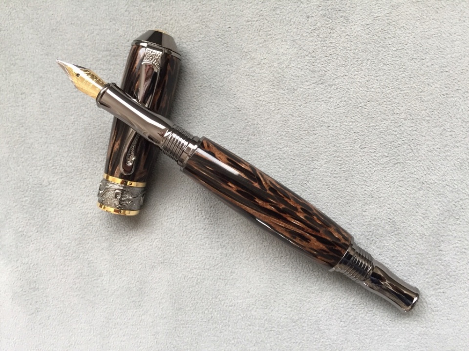

I guess I've just had good luck with palm. I've never had an issue. I do put at least 4 coats of medium CA and then sand up to 12000 so it is pretty thick and covers any imperfections I might have. I also buff them on the wheel when finished. I made this one last night.
