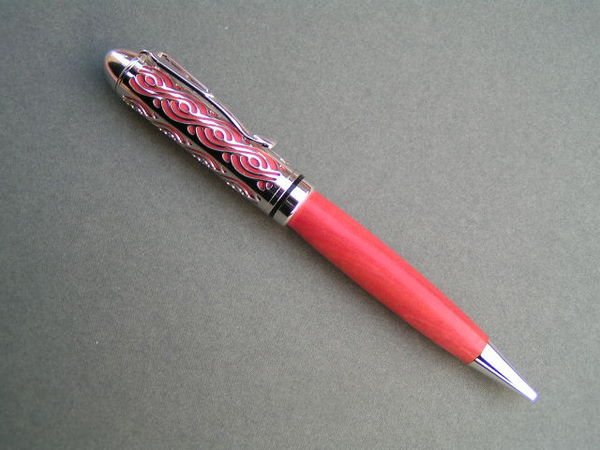

John I just finished one from CSUSA, the wood is pink ivory and it is for a lady.
As said above, watch the dimensions of the upper barrel.

Awesome looking pen. I assume that is a Euro pen with the filigree sleeve on it? If you don't mind my asking, if you were to sell one like it, what would you charge for it?
I would sell it for $145.00. $45.00 of that is what I have them listed on my web site for (Note: that is to low) the other $100 is for having to steal it from Mark.[}:)]
Originally posted by John_Racela
<br />Ligget,
Sorry for replying late, if I were to sell it I would be looking for approx £35 to £40 ($70 to $80 usd), it is the European Filigree and they are being discontinued by CSUSA, discounted now.
They are harder to make because of the top barrel, must keep your length right and bring the diameter down very slowly checking regular to see if the Filigree will slide on without being loose.
Very much a girly pen, especially with the pink ivory![:X][:D]
