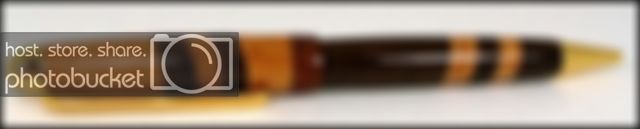

so, this is my first attempt at angled segments. i turned my bandsaw head to 15 degrees and made some cuts, glued 'em up and here's the result.
a modified gold euro with makore (the light wood) and imbuya (the dark) with a leftover piece of curly koa for the centerband.
i thought i wasn't too happy with it, but after all was said and done, i ended up liking it although my bushing fit wasn't very well executed...
thanks for looking, comments always welcome.
I think it looks damn smart, esp the finish. I would have been inclined to use the same imbuya for the cb though.
