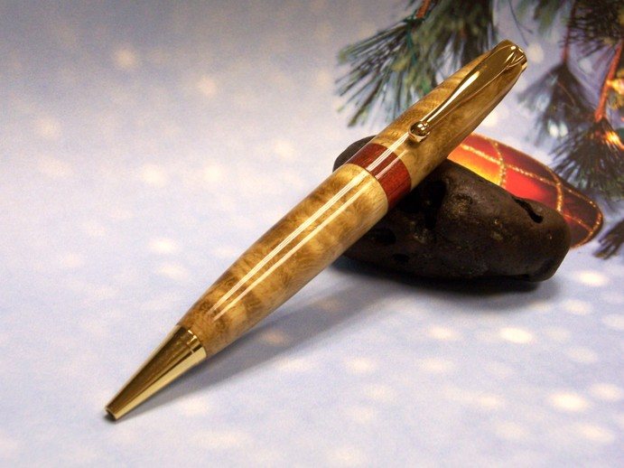

Had botttle stopper mess up on me last night, so rather than call the whole evening a waste, I tried a fatline for the first time. Glad I kept going, turned out to be a great pen!
Fiddleback Eucalyptus Burl, slimline kit, CA finish with TSW. Photo taken at work once again with the good lighting here :)
Yeah, I take advantage of the lighting here at the office. Other angles dont show the finish as well, I have to take a few pics before I really capture it.
Your finish is where I'm heading [8D]
I honestly dont know what the centerband is. It was something laying around my shop. I'm going to say it's redwood, looks a lot like some redwood I have from RTJW.
The photo setup isnt anything special, just happens to work really well. It's the corner of my desk at work. We've got light colored walls, a little natural sunlight, long halogen bulbs overhead. I take the photo with a Kodak EasyShare Z730, no flash, macro mode. I can get them better with a stand, but I dont have one. Also, I move my head and the pen around till the finish is really shining, then that's where I put the camera. Backdrops are just images I snag off webshots, free desktop wallpapers and the like.
The burl doesnt show well, so I may knock out another pic. There's not much of it in the piece anyhow.
Skye, your pens are turning out awesome! The ONLY comment I would have is abandon the cheaper kits and only do the nicer kits. Your pens are too nice.
I also assumed the CB was bloodwood as soon as I looked at it too.

Skye, That's one gorgeous pen. Your finish is flawless. I wish I could get the CA/BLO method I'm working on to look as good. I'm getting more of a matte finish. Maybe I need to switch from medium CA to Thick.

Try skipping the BLO, mine came out matte also.
