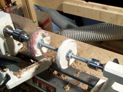

Well, call me crazy (you might as well, everyone else does)... But sometimes, I like to do stuff myself (call me cheap, too.) [;)]

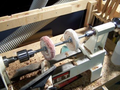

The buffing wheels are from Harbor Freight. $3.99 each. Set on a 1/2" treaded rod from Home Depot ($2.99) and some washers and nuts (another $2.00). VOILA! A buffing system! The threaded rod mounts in my Jacob's chuck. I picked up the Tripoli and White Diamond at Woodcraft.

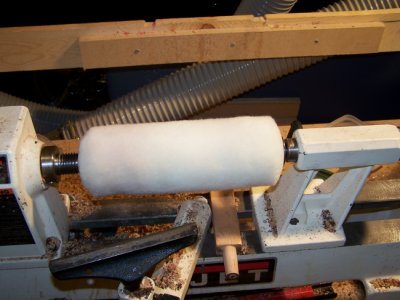

For the final buff, I use a Labmswool Paint roller.
<br />

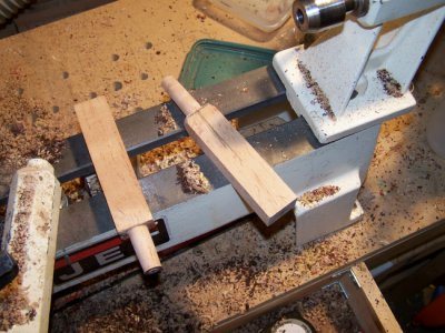

I ripped some scrap wood to the exact size (i.d.) of the roller and turned a MT2 taper on one end...
<br />

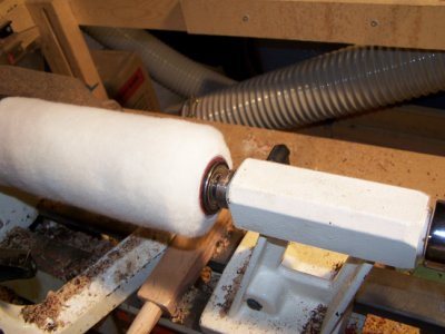

The other end fits perfectly into my tailstock.
<br />
1/2 of the roller gets Carnuba wax, the other 1/2 is unwaxed.

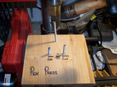

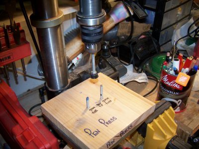

For the pen press, it sits on my drill press. 1/4" threaded rod fits 7mm tubes like a glove. Its smooth, easy to control and cost exactly $3.00 to make.

Steven your are the man! Nice write up. I had an old HF lathe that I used to make the same setup you show for your wheels but I haven't done the paint roller yet. Soon.....
