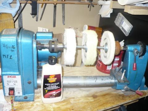

Meguiar's Mirror Glaze; Show car glaze, #7;
In addition to Huts products I've also used the liquid compound that is used to clean up the haze on plastic headlights. It seems to work as good as the more expensive stuff that is sold specifically for pens. The final polish is always a couple of coats of Turtle Wax ICE.
