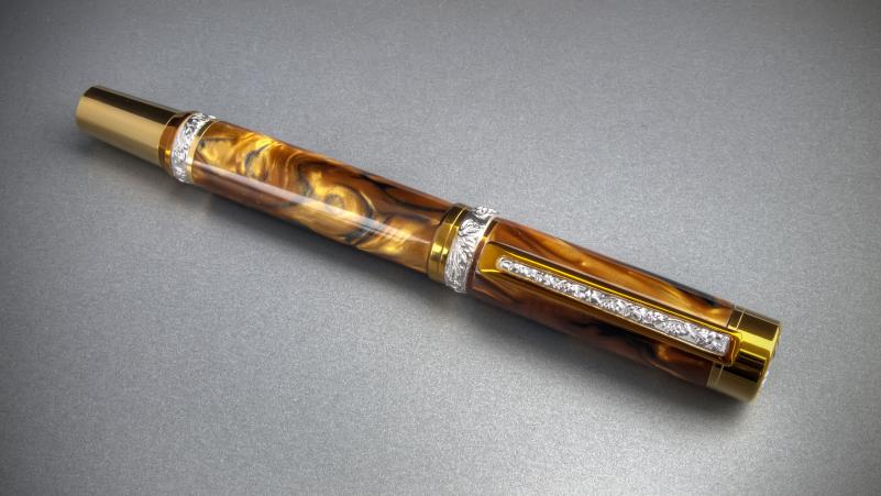

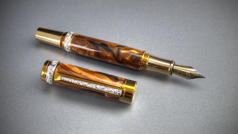

Hi there,
just a few photos of the roman harvest with suspect plating, the original fault was noticed after a final light hand polich just to remove prints and add an extra gloss. I can only assume that either the non abrasive car polish i used reacted with the epoxy coating/plating or the plating is faulty. To try and improve matters i decided to spend over an hour polishing the hardware to get a uniform finish. Im not sure whether it looks right, i may just take it apart and fit it with different plated hardware. whats your opinions????

Most car wax has a fine grit compound added to help clean the paint but if you put it on and off by hand it should not be a problem but if done on a machine it can cut just a bit of paint off . I use Plexus spray on plastic polish and clean up buy hand. if you dont have that Lemon Pledge is about the same and much cheaper. can see a bit of a difference but it still looks very good
Looks almost like it's gone down to the brass. The second picture makes the pen seem like it's been assembled using two different kits.
This is quite worrying as the RH is one of my favourite kits that I advertise as a medium to high end set of components. Hopefully David will see the posts and offer some advice.
Other than the plating issues it's a lovely blank, and the fit and finish look spot on.
Disassemble immediately, and put those blanks on a new component set. The blank to plating match is beautiful, but the plating mismatch, ruins it.
With out a doubt it's a QC problem,it looks like the kit was skip plated and a few pieces
missed the gold application,like Twissy said it looks like brass now .
It is worth changing out the hardware the tubes are beautiful.

Rich - 1st of all there is no such thing as a non-abrasive car polish, its like say a non-abrasive sandpaper. I think the earlier responses have answered this quite well. After an hour polishing, you have stripped away the upgrade gold finish and exposed the gold titanium layer underneath, if you keep going you will get down to solid brass. To get down to the gold titanium it normally take months if not years to happen under normal daily use of the pen.
The splotches or scratches you tried to remove were either caused in the transportation from the factory in Taiwan to our warehouse in Australia or from the transportation from our warehouse in Australia to you in the UK - courier companies are known to miss handle parcel which could of caused a scratch. The other cause may be a chemical reaction with the gules you use or the chemical you use to polish. Either way I am alway happy to replace the parts or give you a full refund.

Purely by chance, after Twissy told me this thread had reappeared, and again by chance i met the customer who bought this pen over a year ago. The results are in my opinion very good. The top layer of upgrade gold had completely worn off the nib section which was the only bit i didnt clean up, this now matches the other components. This pen is in use everyday and the owner uses on average 1 disposable cartridge a day, thats some writing. With a bit of ren wax and a wipe it looked as good as new, it still has the original nib in too and writes amazingly smooth.
