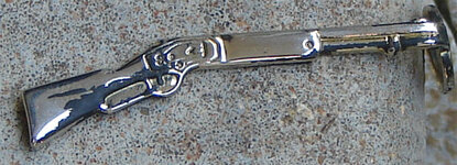

A common question here, and at other forums, involves where to find or how to customize pen clips. The selection of unique or 'theme' clips is somewhat limited. The most popular (in my case, the Christian Cross) come only in gold colored.
Right now, I am wanting a cross in silver but none can be purchased. It would go on a European with pink acrylic. (I know, I'm the "wood only" guy. enuf of that for now.) This would be a gift to a friend's wife who is battling breast cancer. I don't think gold would be complimentary to the pink.
Enneyhow, I have this rifle clip that didn't hold up to normal use very long. The gold wore off quickly exposing the silver-colored nickel underlayment.
The experiment involved removing the remaining gold to turn this into an all silver-colored clip. I chucked up my cloth buffer and charged it with light green rouge. It quickly removed the gold highlights. But, if I held for a fraction of a second too long, it also removed the nickel exposing black colored steel underneath.
Agreed, simple experiment. A different rouge might give different results. Although, the manufacturers represent the green as the ideal rouge for this sort of use. Enneyhow, I present this failure for whatever use the information might be to others.
Failed clip

On the buffing - I have a couple of cheap plated gold pens in which the plating wore off in spots. I disassembled the pens and buffed the plating off altogether. It had more of a "silver" appearance in its warmth than platinum or chrome. Worked well. I used a very light touch and .2 micron paste available here.
