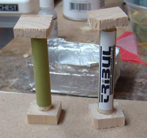

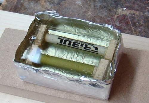

I tried making a casting with a company logo. I printed the logo onto a label and put the label on the tubes. I used Don Ward's snake skin blank instructions and glued a cork into one end of the tubes, filled the tubes with BBs and glued the other cork in. Then I glued 3/4 inch square pieces of wood to the end of these, put them in a mold and poured in my PR. Put it in my pressure tank with about 40 PSI. When I cut them apart I found that PR had gotten into both the tubes. The only way in is past the corks. I thought I had plenty of glue, but was trying to be careful not to get it on the outside. What can I do next time to get better results?

Too bad, they look pretty cool!
Have you considered salvaging them by drilling a 1/4" hole in the middle and using them as slimline tubes? You could try drilling them out with larger diameter bits, too.
Not sure how to protect from leaks - I haven't tried pressure casting. However, something you might try if it continues to be a problem is to coat the inside of the tubes with wax before you put the corks in - that should keep the PR from bonding with the tubes, and allow you to simply push out the PR.

Thanks Jim. I did try drilling them out, but I think with the BBs being round they would cause the bit to put a lot of pressure against the side of the tube and cause the outside to look like the PR shattered slightly.
Excellent idea on the wax though, I'll give that a try.

If you have access to an ultrasonic jewelry cleaner, try degasing the resin for about 5 - 10 munutes prior to casting. I put about 1/2 inch of water in bottom of the cleaner, pour the amount of resin I want to use in another plastic container and set that container in the cleaner. This gets most of the dissolved air out of solution. Then you only need to pressure cast at 5-10 psi. You may even be able to get bubble free without degasing, but its safer if you can. With lower pressure, I rarely get resin in the tubes and when I do, its only a little bit. I use small pieces of drill rod instead of BBs. Even if there is a little resin in the tube, just place it over a hole in a block and tap it out. I also extend the label about 1/32" beyond the tube to help make a seal. Not sure if it helps, but I haven't lost one to resin in the tube for quite a while.
Also not sure if you painted the tube with a lot of white in the label. On some of mine, the tubes show through making the white a little dull.

I haved used Don's snakeskin tutorial alot and only had the first cast get into the tubes. I actually super glue the cork inside of the tube by running a good bead of ca on the cork then jab it into the tubes. I also just cast at 30-35 psi. Don't have a clue if that helps or not.

I take thin CA and run it all over the outside of the cork and let it set in. I get a little leak, but not as much as before.
I saw a post for the Silicone Corks/Plugs, haven't gotten around to buying any though.

If you are doing bigger pens my local True Value hardware carries little rubber plugs as well as the cork ones. Completely smooth without the natural voids of cheap cork.

I am now using an ultrasonic jewelery cleaner instead of the vacuum. THANKS Bruce for your advice on this. I also run a bead of CA around the cork and press it in snuggly. I have dropped the pressure back to 20 psi, but Bruce's suggestion of less pressure will work also. I have not had any leaks of PR into the tubes. When a tube does leak, or I should say used to leak, I had some luck with a punch (as large as I could use on the tube that leaked) used to drive out the PR plug. It does not always work, but its worth a try. I also now use small lead shot used to reload shot gun shells. The lead is softer than BBs and is easier to drill but I think the lead also lends the plug easier to drive out. I had no luck driving out the PR BB plugs.

Steve, when you have glued the first plug cork on the tube take a Q-tip with glycerine coat the inside tube with it and taking care not to put any glycerin on the tube edge where the second cork plug will fit, your plug should be press in the tube, CA glue is easy to remove from the inside tube, anothe matter reduce your PSI to 20, if you worries about bubbles then pressurise the PR in the mixing cup first them pour the PR in the mold and pressurise again
