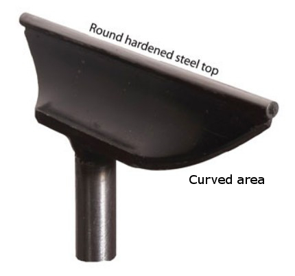

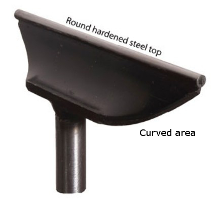

Jyd -
I apologize if I appear dense, but I'm still having trouble understanding exactly the problem you have with the EasyGlide tool rest.
I've attached a picture of the tool rest from the PSI catalog that is annotated to show the working edge and the area that is intended to be curved. If the problem you have is that the working edge is not straight, but rather has curved ends, then that sounds to me like a product defect that you should be discussing with PSI. I have found that calling their customer service group on the phone usually gets very good results.
But if the problem is that the unique way that you are using you lathe causes that normally-curved plate that supports the working edge to be a problem, then perhaps the solution for you is a bar-type tool rest. PSI has some, but in that case, I would echo Clark Miles suggestion that you contact Rick Herrell - I bought a replacement tool rest for my previous lathe from him, and can attest to the fact that they are well made (almost to the point of being so nice looking that you don't want to actually use them), and because it's a round bar, that curved plate won't be in the way.
