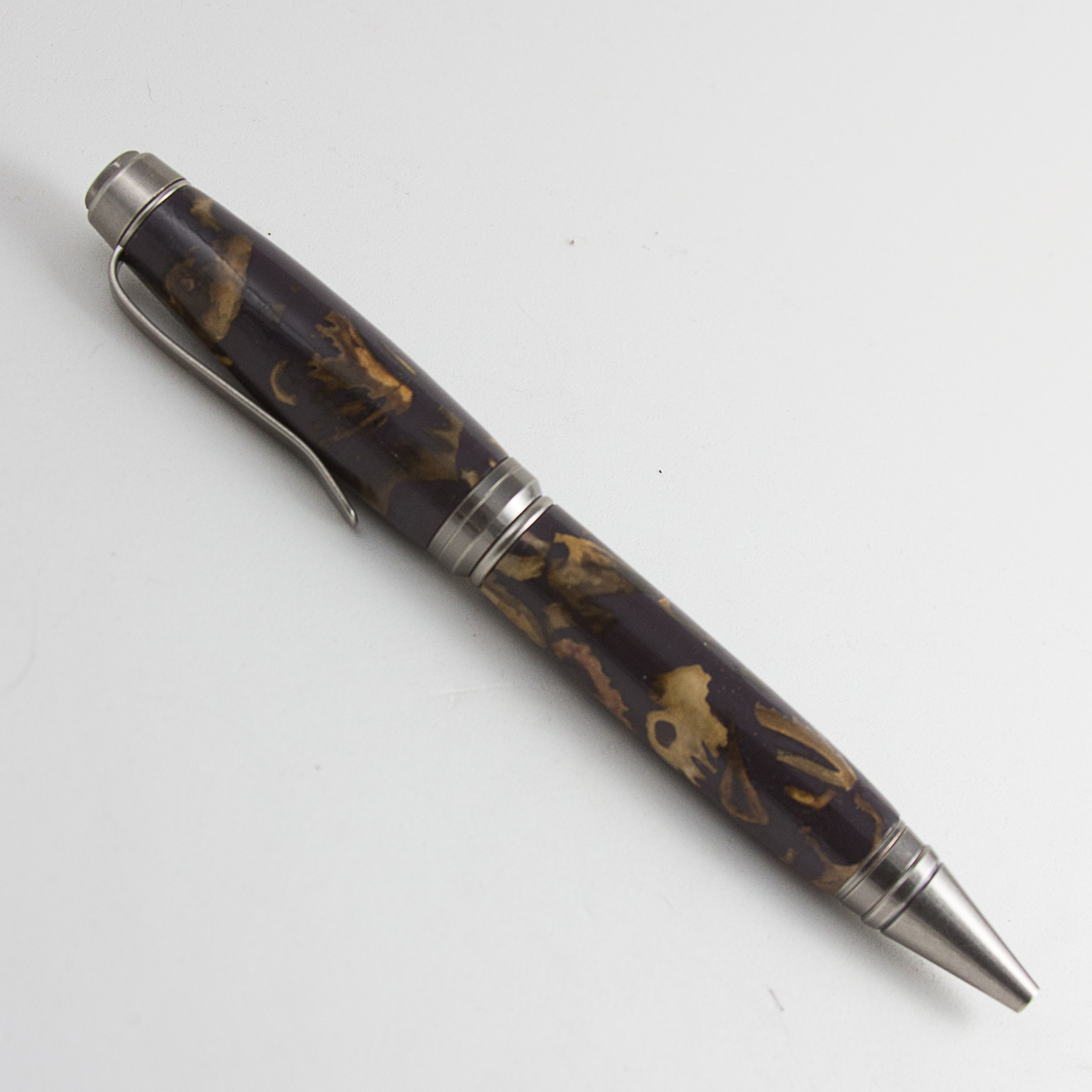

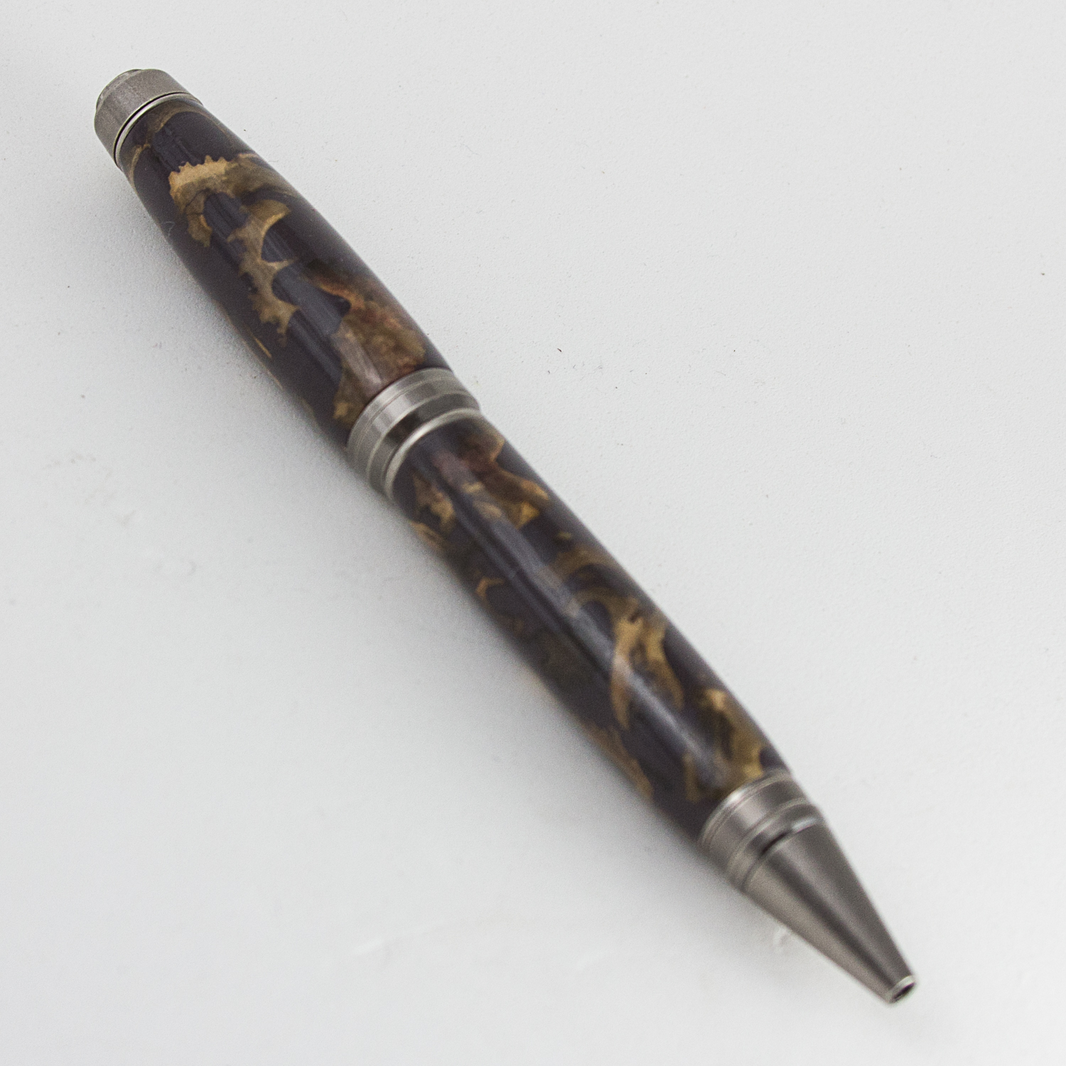

The first cast with brown colored resin is a Cigar. I think it is interesting but definitely shows the need for smaller pieces of nut hull.

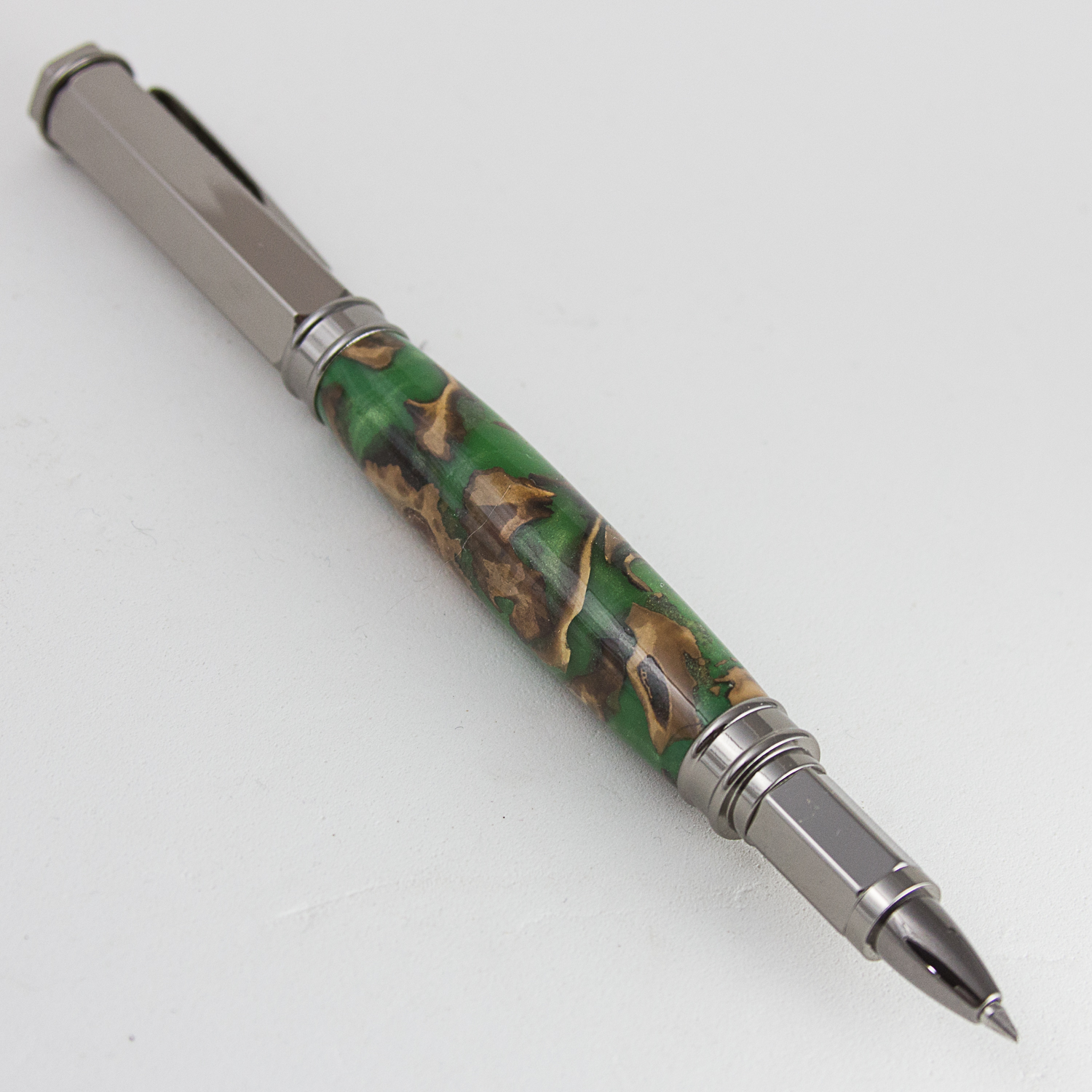

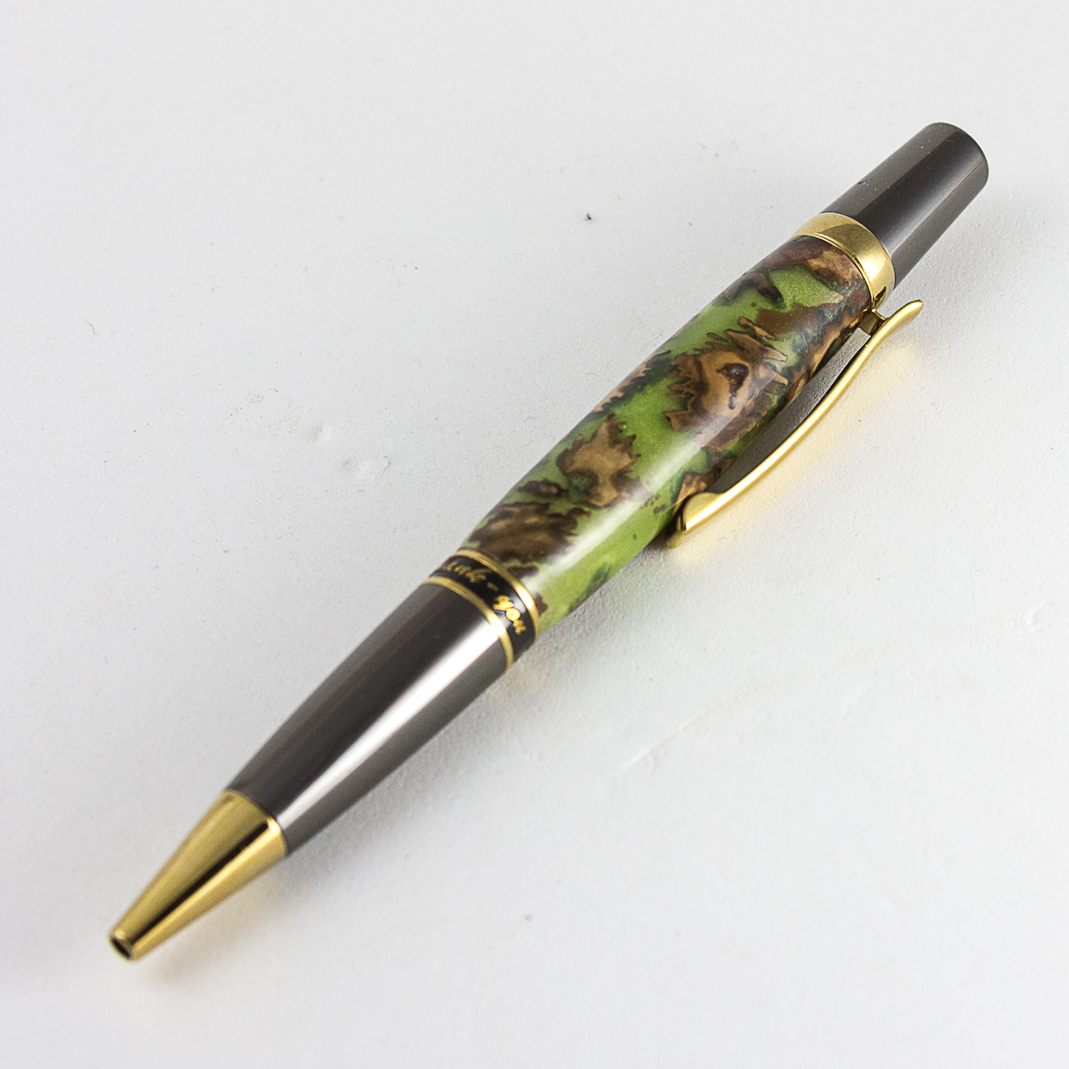

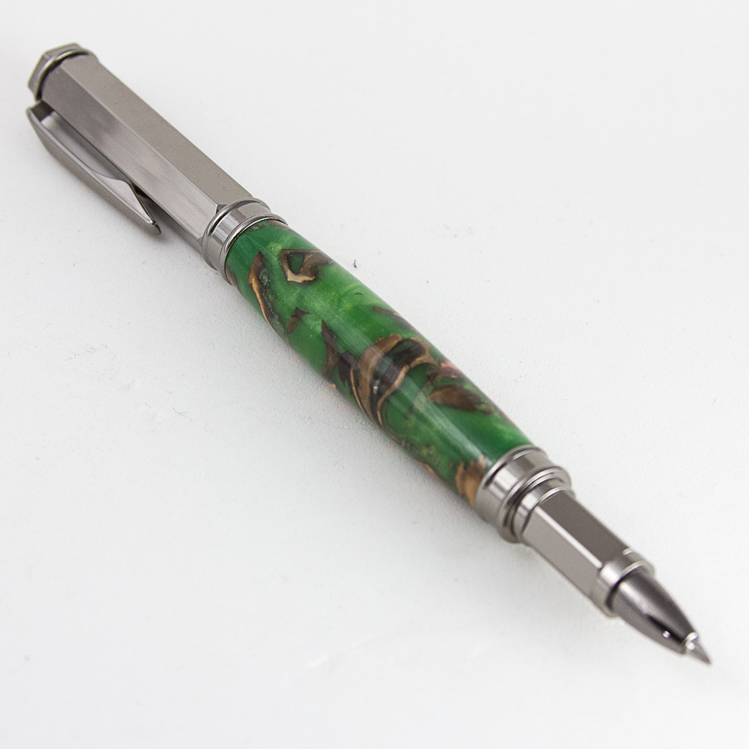

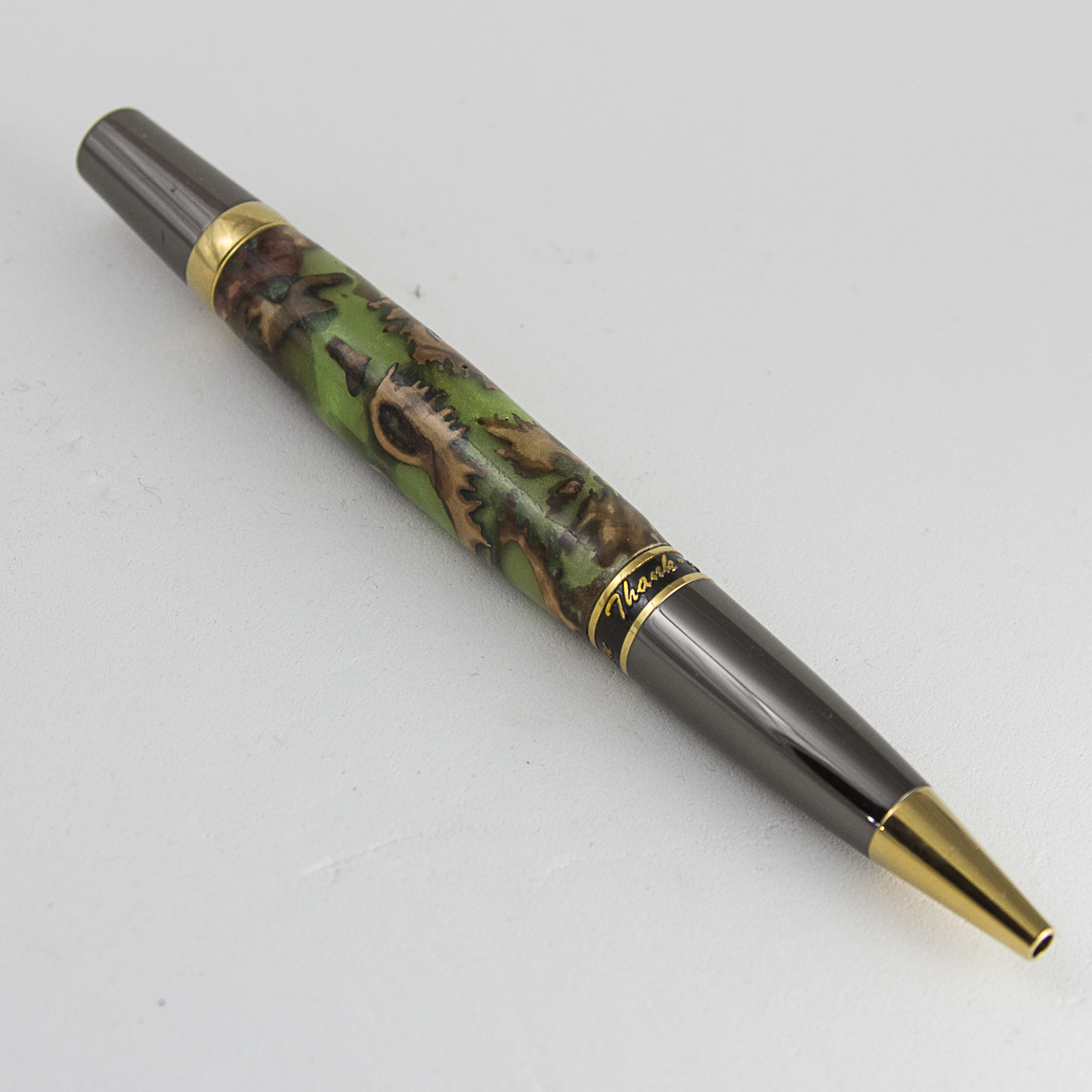

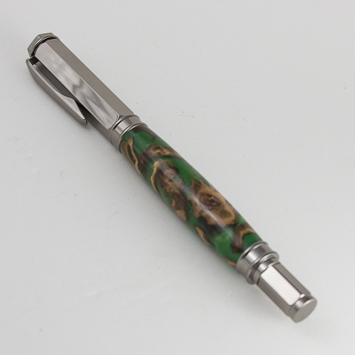

The second cast was done after looking up previous efforts here on IAP. I got two pens from it. The drilled blank for the Thank You pen was painted with a wine color and the hole for the Vertex pen was painted green. Thus the different shades in the two.

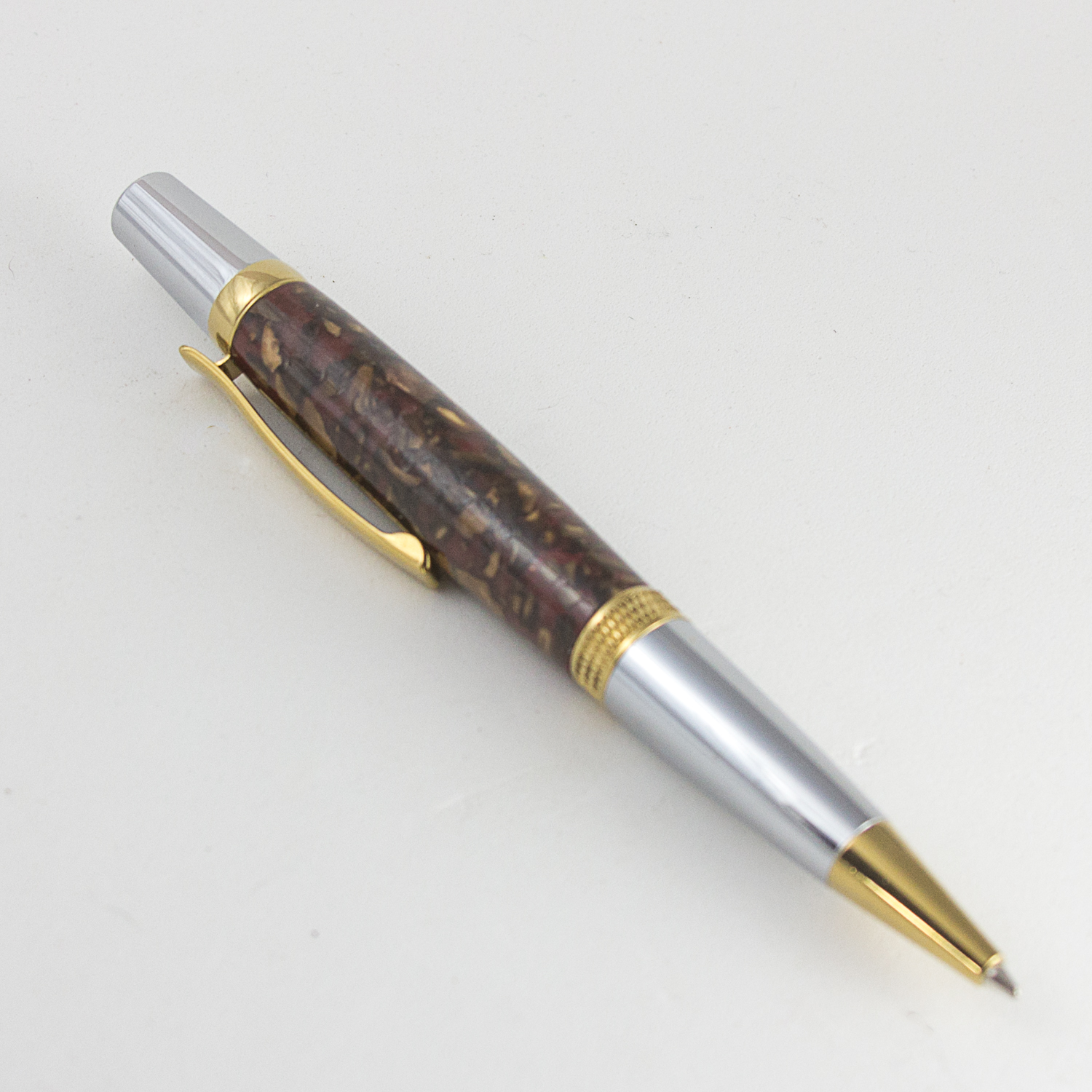

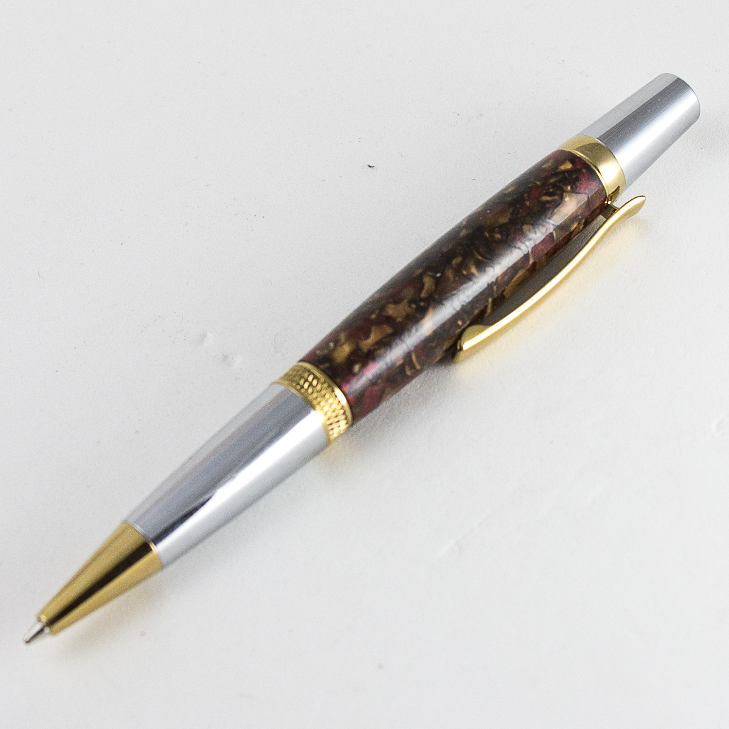

The fourth pen shown was done with more highly pulverized pieces of the remaining supply of black walnut hull. Due to my supply being low I had to do a tube in cast. The cast looked fine but as I turned the pen down it was obvious the color either wasn't fully mixed in the epoxy or some separation occurred under pressure as the wine colored tube was clearly visible in some spots. When I poured the resin seemed quite uniform in color.
