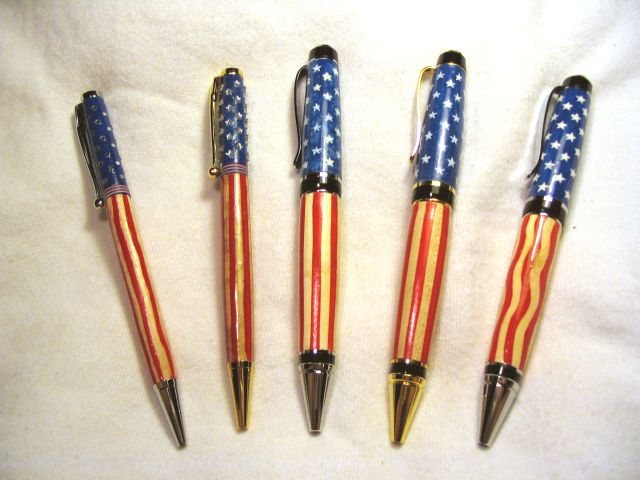

As Forth of July is quickly approaching, I experimented on a few Stars and Stripes pens. Not all of them came out well, but they help me learn a few things along the way.
From left to right:
A reverse Longwood modification of a Slimline.
Center band is made with red, white, and blue plastic plates.
The red stripes are inlay with red 3D paint. Tried to add wiggles to the stripes.
The blue top is painted with acrylic paint.
Stars are nail art glitter.
The finish is a brush on Minwax Polycrylic clear gloss.
Wood is Cottonwood.
Everything same except,
The red stripes is painted with acrylic paint - straight stripes.
Stars are nail art rhinestones.
Wood is White Ash.
The next two cigars are the same except the left one is Cottonwood and the right one is Maple.
Stars are inlay with white acrylic paint.
The finish is a brush on Minwax Polycrylic Clear gloss.
The cigar on the far right is Maple.
The red stripes is painted with acrylic paint - wiggled stripes.
Stars are painted with white acrylic paint.
What I've learned doing these experiments:
Cottonwood is very white in color but it doesn't paint as well as Maple.
White Ash is not white enough.
Cutting inlay into the wood is very hard to do and painting is much easier.
Minwax Polycrylic has a rubber feel to it.
Using things like nail art glitter or rhinestones makes the pen almost unusable due to fear of knocking off the starts.
Using Scotch tape and cutting out the shapes to be painted makes the edges much cleaner.
From these experiments, I'm hoping I can make my next Starts and Stripes pen much better.
-CT

Thanks for the kind words. One correction, the pen on the right is Cottonwood, not Maple.

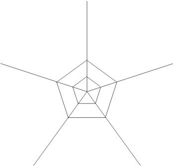

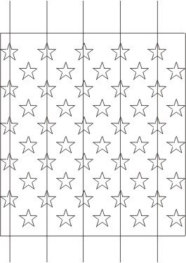

To make the stars, I used some simple math to determine the size of the stars I need. I then created two computer printed out templates that I made with my drawing program.
<br />
<br />
I first prep the blank by painting the blue color in, since I can't really paint it after I put in the stars. After the paint dries (several coats were needed), I put scotch tape all around the blank to protect the blue paint.

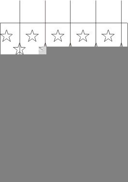

I use the pentagon with the lines template to mark the blank into five equal parts. I then cut the star pattern template along the lines (indicated below) and glue the strips of stars on to the tape, making sure the stars line up with the marks I made.
<br />
I use a X-acto knife to cut out the stars. I paint several coats of paint on the cut out stars, checking to make sure I removed the cut out pattern of the tape or I would be painting on the tape instead of the blank. I then use a second star pattern template and cut along the second lines (indicated below) and glue the them between the first set of stars. I repeat the process of cutting, and painting.
