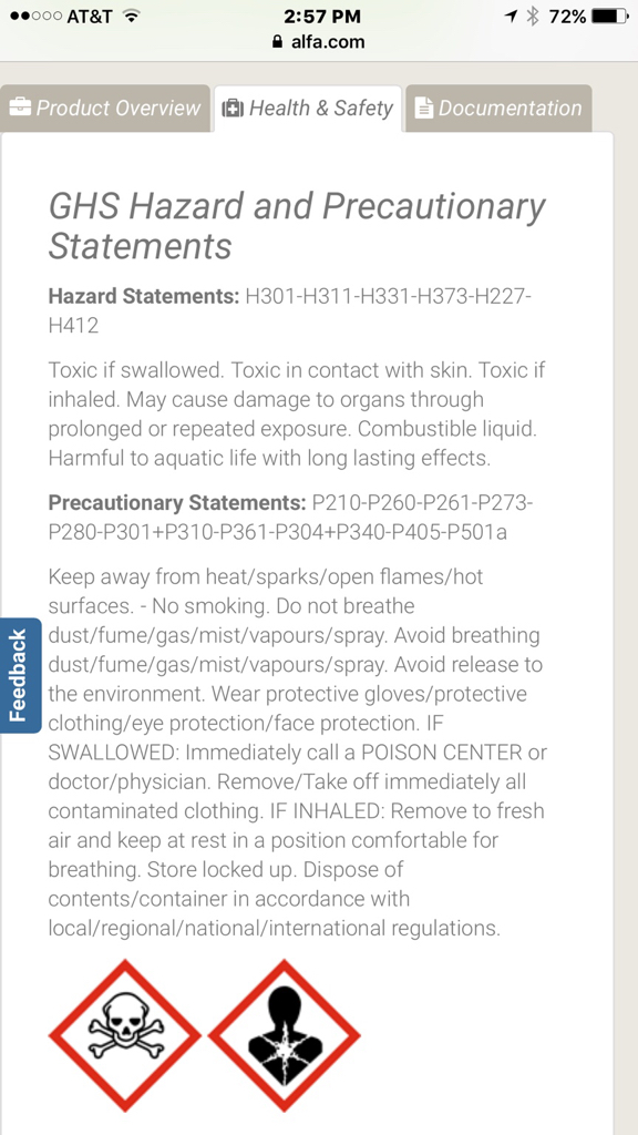

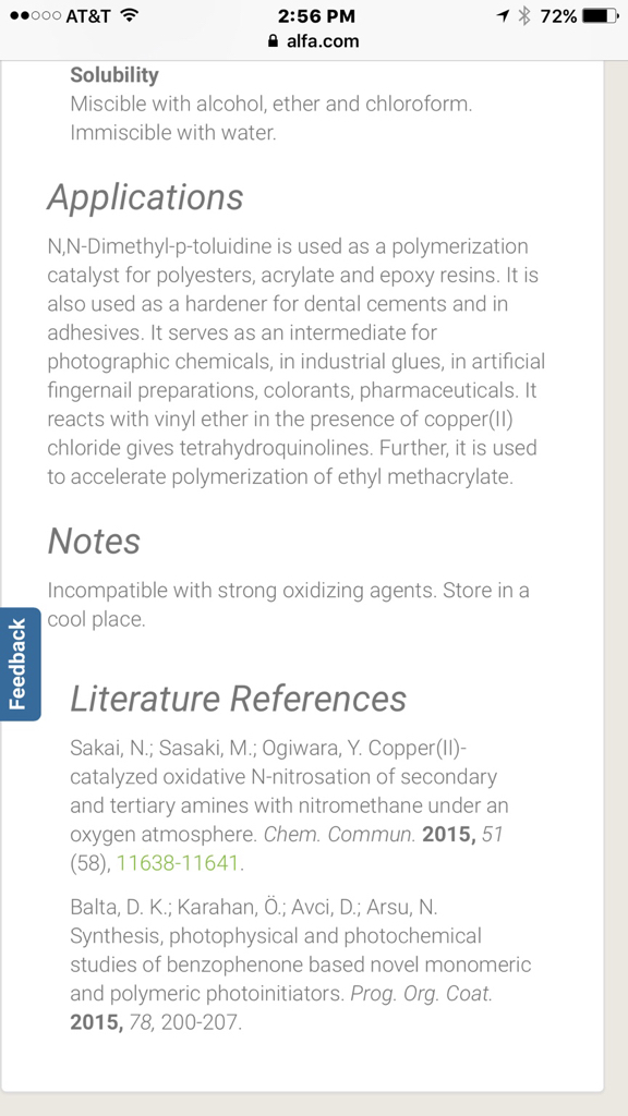

I ordered BSI accelerator but was sent Zap accelerator consisting of "Isopropyl Alcohol and N,N-Dimethyl-p-Toludine". You said Naptha and Heptane are good, I have no idea what Isopropyl Alcohol and N,N-Dimethyl-p-Toludine are xD Will this kill my finishes?
Not familiar with it in sure many have used it before. From the screenshots here it's not good stuff.
Note the skin contact and hardener for epoxy.
Hmm, doesn't sound too great. Looks like I might have to try something else. Thanks for all the help edstreet!

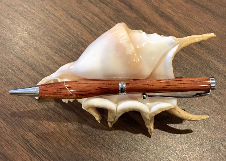

Just finished my first pen with odorless CA
I used my 'normal' procedure for applying the finish, but used Bob Smith Industries Super Gold and Super Gold + CA instead of 2P-10 thin and medium.
John indicated in his response that it flows differently from other CA glues. I experienced a difference with just the thin CA. I was able to adjust my application method right away and it was just fine.
My 'normal' procedure includes using two or three microbursts of accelerator after each coat, then feeling the blank to make sure it is dry before applying the next coat of CA. I use NCF Quick aerosol accelerator and it worked just fine.
I am satisfied that this is a good alternative for me. I had an allergic reaction to the 2P-10 when I went into production mode and was doing a number of pens at the same time.
