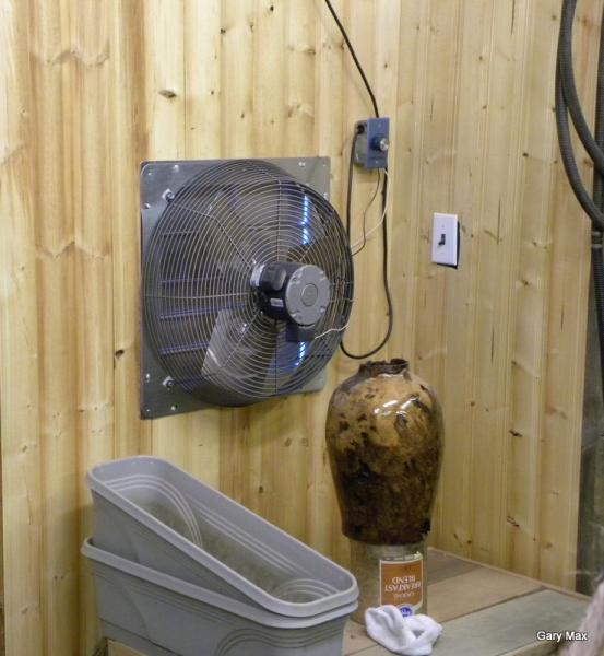

I just got this installed yesterday. Rated at 2,000 CFM it should hlep keep the dust down so I can shot with my HVLP.
Sure would of been nice to have a seperate paint room but I don't have the space.

This one is explosion proof----I am getting funny about safety.
With the speed controler (which was Extra) just under $300.00.
It's a real nice unit-----alum. construction.

Gary that looks like it would work but you will probably need to add some filters in front of it to keep the overspray from clogging the motor and blades.
With the variable speed control, you can set up a couple "walls" by using shower curtains. Side them out when needed and tied back against the wall(s) when not. This will help contain the over spray and allow the fan to move most of it out before it floats throughout the shop. The heavier the curtain the better and you can also weight the bottoms to keep them from getting pulled along with the draft. I have seen automotive spray booths set up this way and they work quite well at controlling over spray.
As mentioned, you should add filters not only to protect the motor but also so your not simply dumping the spent medium outside. And also, it is not a
big issue as of yet, but with the EPA's new NESHAP law concerning body shops (and thusly home auto body projects), it won't be long before any and all home spraying operations which atomize with pressure any type of VOC materials will become regulated too. At least rattle cans are safe!! For now!!!!!!
