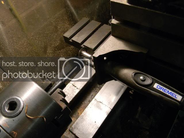

A dremal tool mounted to a vertical slide to enable 3 axis movement
HSS 0.4 cutting discs (0.2 or 0.3 wold be better)

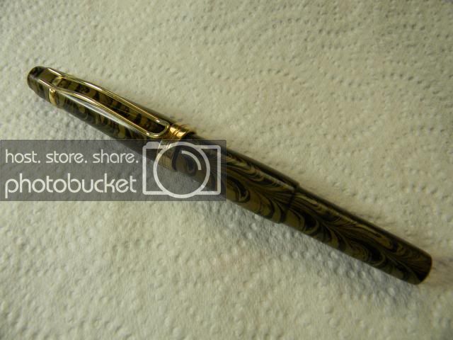

The finished pens:

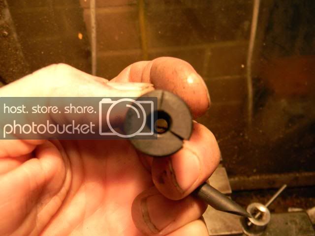

A bush with 3 slots to hold the feed and apply some pressure so it won't move:
The dremal set up:

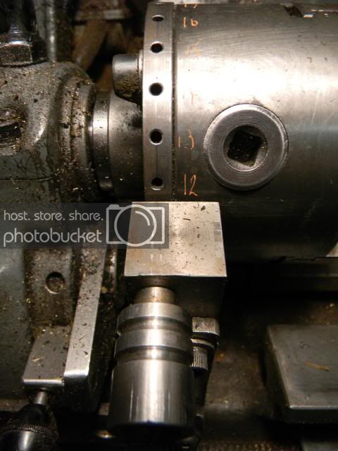

An indexing plunger with 24 holes in the chuck plate (24 is a good number with some good factors, I would have prefer ed 60 holes....but space would not allow it and this attachment was made several yrs ago. :

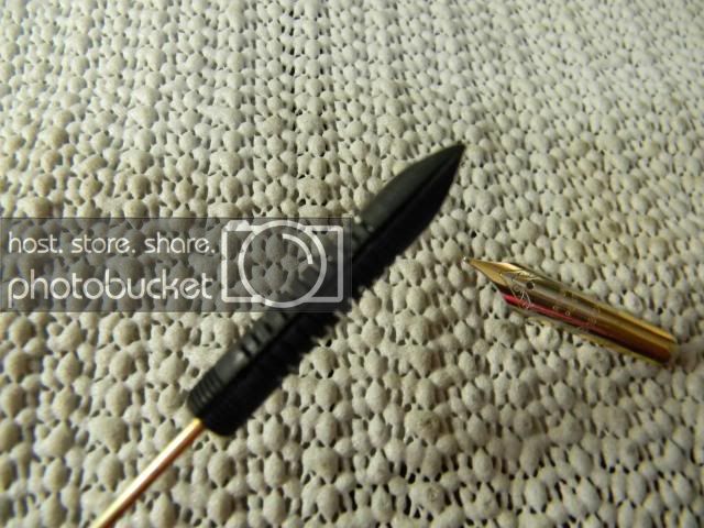

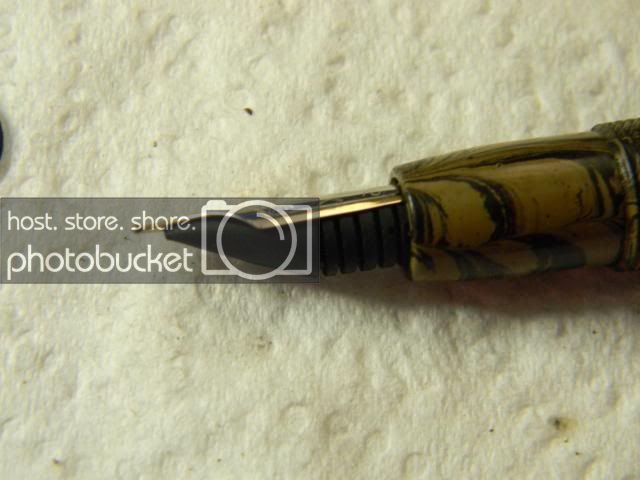

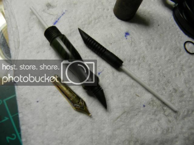

The finished feed with breather in brass tube, note plastic is better as the brass can react with some inks. The feed is adjusted by deepening the slot with a razor saw.

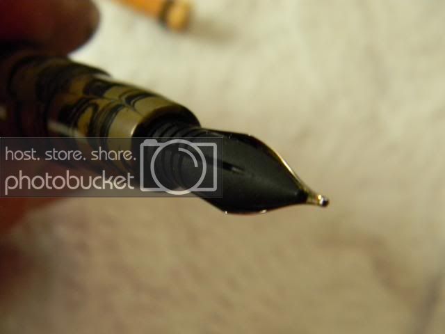

The finished feed instaled:

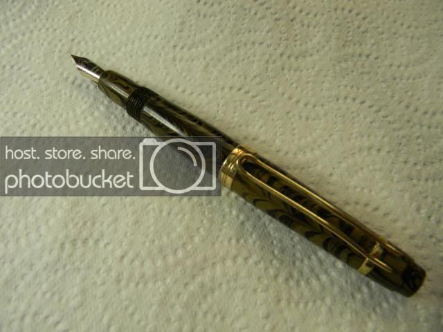

The finished pens:
