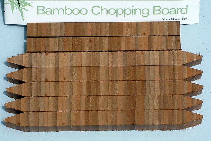

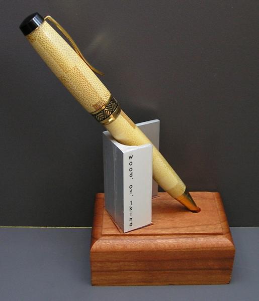

A Slimline Cross Cut from a Bamboo Cutting Board as also shown. You can buy laminated Bamboo or straight light cutting boards or mixtures.
Have fun Peter.

There have been several over the past couple of years. A few even took small diameter (1/2 to 3/4 in) thick bamboo, drilled it, turned it and made some fine pens. Looked nice.

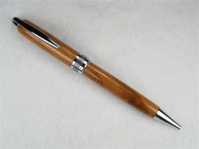

Hi Brian; Here's one I just finished. It's a Chrome Olympia on it's way to a Canadian Peacekeeper in Afghanistan.
No issues at all, straight turning, sands beautifully and easily.

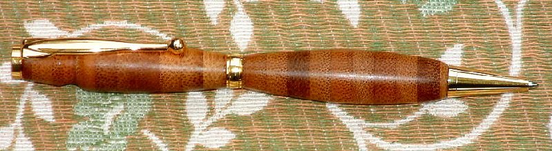

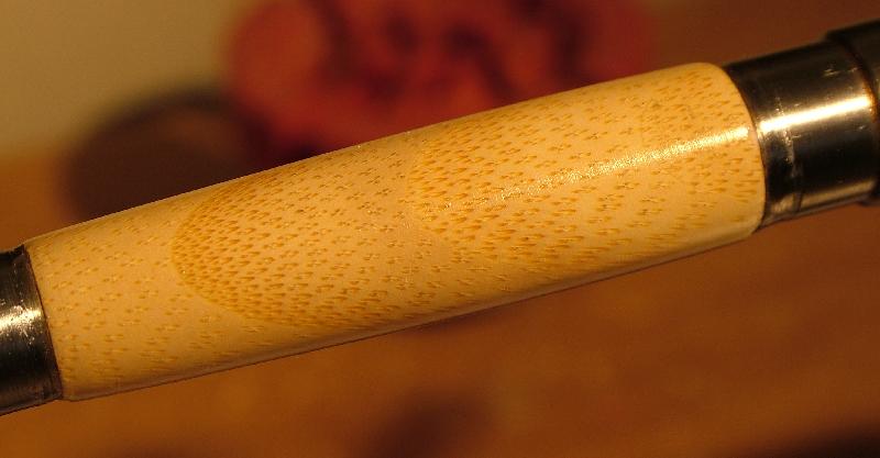

I've made many of them and they look interesting. OF course, now that I
need to find a pic, I can't find a finished pen. But they look just
like Mack's picture. Mine came from laminated cutting boards, as mentioned.
They were on sale at the dollar store and I got a dozen blanks out of each
one.
As you said, bamboo is a grass. So when you cut it, it can get stringy.
But it turns nice and takes a polish.
The nice thing is that since it is a grass, it is full of capillaries that suck up
any oil you put on it.. and the oil acts like a fiber optic light tunnel. So you
get these glowing veins in the wood and the ends light up in pinpoints.
So your pen looks a little like a Lite Bright. :tongue:

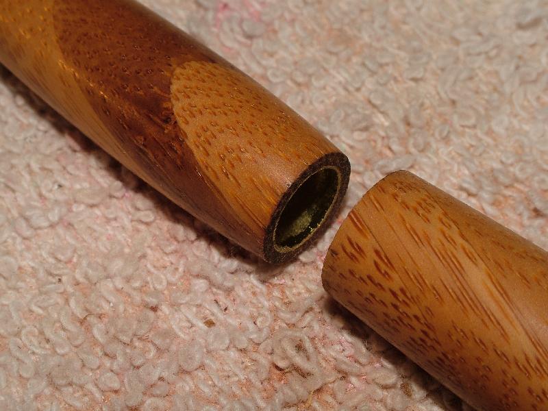

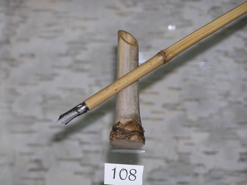

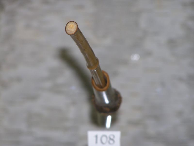

Here are a couple more. A neighbor of mine has a lot of Bamboo growing in there yard.
One is a slimline and the other is just a dip pen with a stand.

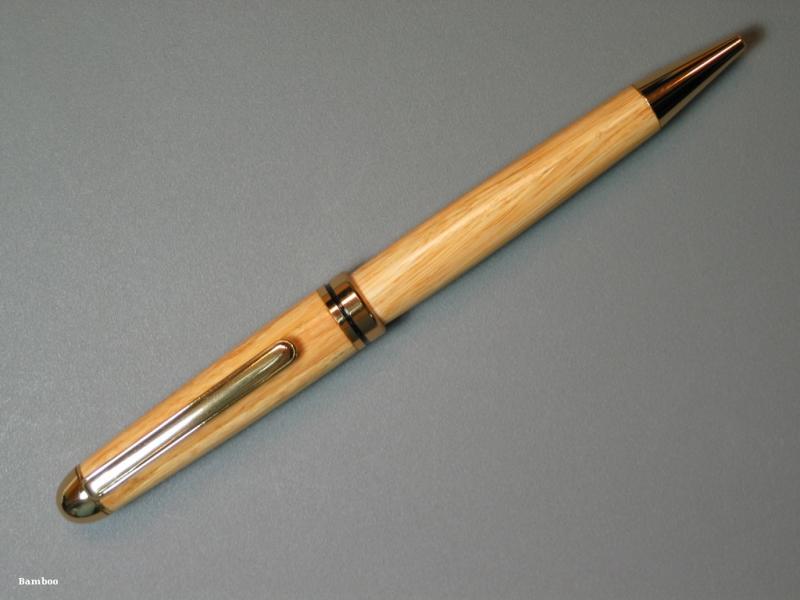

here is a bamboo Pen i did 11/08 for a company i work for that deals with bamboo products (Cariloha) it turned out pretty good.
